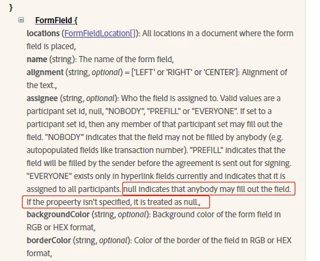

I also found some issues in Form Field API calls. When I use (/agreements/{agreementId}/formFields) and the "assignee" is null because i want to send five people, But the custom signature does not appear, and the signature block is used by default,why?

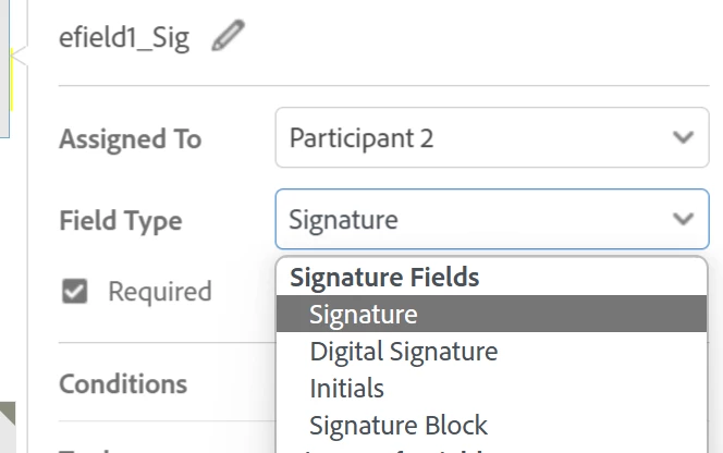

What are the required signature fields that are needed on templates, as I always add the required signature fields for each of the signers. However, Adobe continues to add the Signature Block. Is this a configuration I need to change, because again, the fields I'm adding is the signature field, and they are set to required.
mariahweyne
Jul 26, 2023 8:02 PM UTC
Vertify the signature type that was added in your template.  Make sure it says Signature and not Signature Block.
