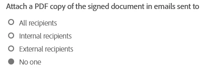

It seems that you are referring to the PDF attachment sent via email to each signer and sender after all the recipients sign the document.
It is possible to disable the PDF attachment. However, the feature is not available with your current plan.
The option to remove the PDF attachment is available with the Acrobat Sign Team, Business, and Enterprise plan.
Check the screenshot for reference:
Let us know if you have any questions.
