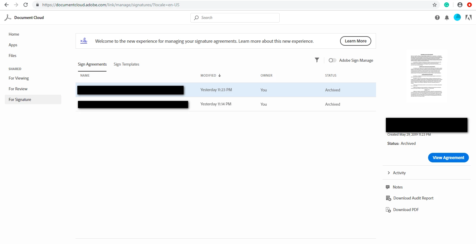

I have used the Adobe Reader desktop application to sign two documents.  Adobe generated a URL for them, and I downloaded the signed files from my Document Cloud.  The documents show a status of 'Archived'.  I want to delete those files, but there is no option to do so.  How may I accomplish this?
I have attached a screenshot with redacted filenames showing the options that I have to work with.  Thank you for your assistance.

Hi Mj,
Sorry for the delay in response.
Please refer to the information mentioned below in order to delete the document from Manage page or from the Account in Adobe Sign.
  • If you are trying to remove the account from the manage page, then use the "Hide" option provided when you select the document from the list. That option will remove the document from the Manage page in your account.
  • In case, you are using Document Cloud to access Adobe Sign account, use the steps provided below in order to delete the document from Adobe Sign account permanently.
     - In the account, click on the circle in blue provided at the extreme right-hand side of the screen.
    - Select Settings > Edit signature settings.
   - Then select "Privacy" from the left-hand side pane.
   - Enter the email address of the recipient in the search bar. That will open all the documents for that particular recipient.
   - Select the document from the list that needs to be deleted.
   - Click on the trash icon provided at the extreme right-hand side of the document.
Hope the information helps.
Let us know if you have any questions.
Meenakshi

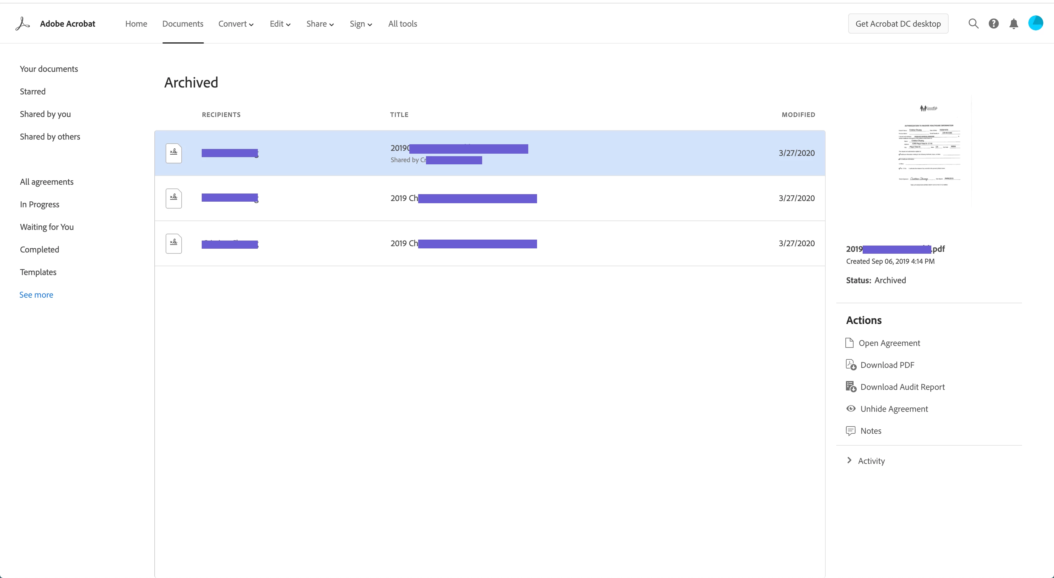

Aug 6, 2021 5:49 PM UTC
Unfortunately this method is no longer valid. If the documents were signed and saved, they are archived to the documentcloud.adobe and the option to "delete" is not available. There appears to be no way for the end user to delete the pdf?

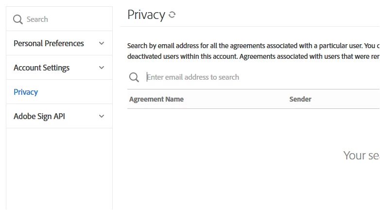

  1. I want to unshare documents and delete them from the system permanently but I'm having issues doing so.
  2. When I try to delete them through my settings > signatures > privacy, there are no argreements listed on the page for me to delete, despite clearly having documents listed on document cloud.
  3. Both archived and hidden documents that I have previously shared are still accessible to anyone who clicks on the share link.
  4. This is not compliant with GDPR.
  5. Please help with this issue.

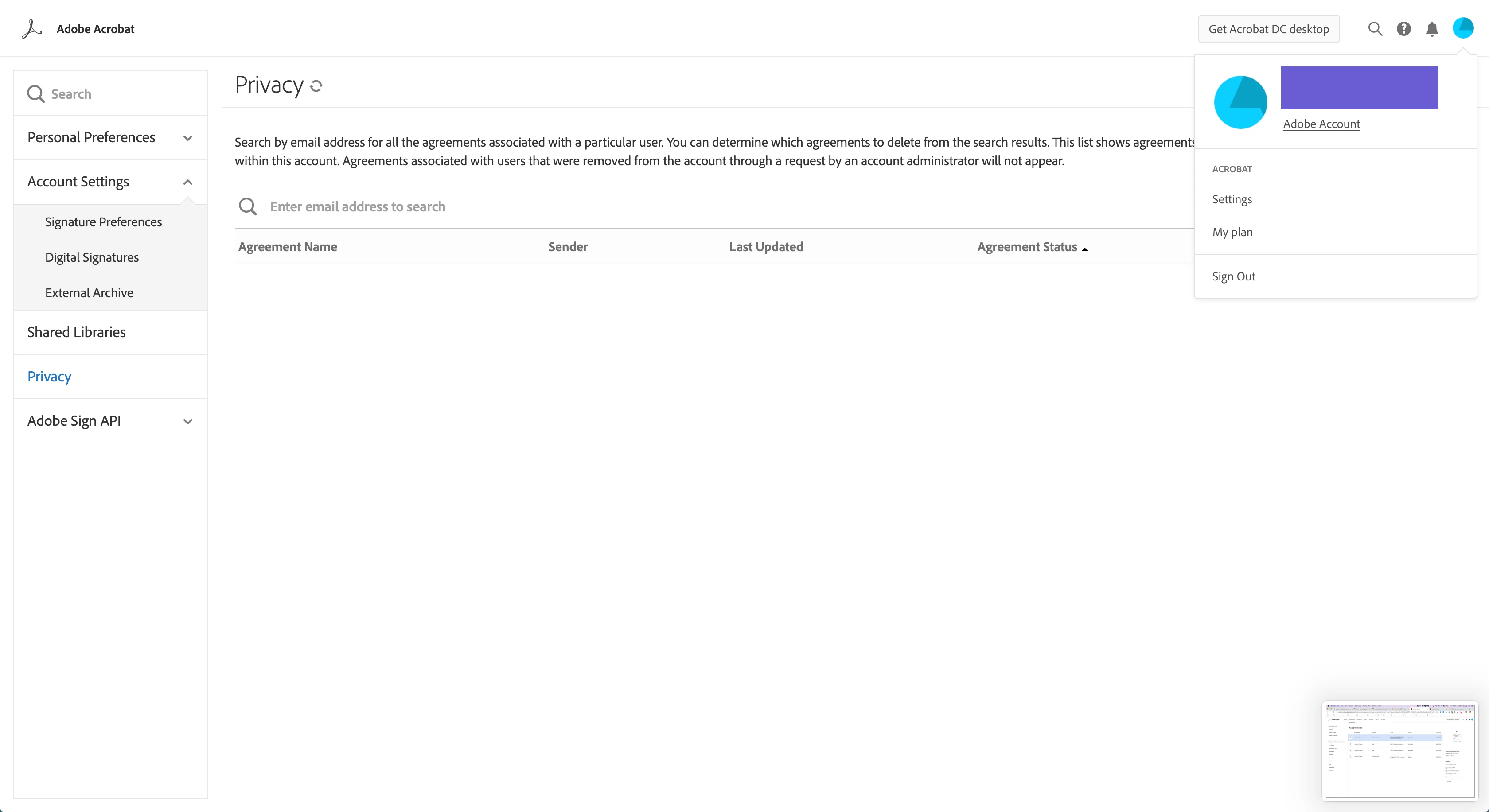

Aug 12, 2020 10:01 PM UTC
You need to search for your email in the search bar (see where it says 'Enter email...' in your 2nd image), try the email associated with your account. The list is blank by default.
Mar 15, 2021 3:58 PM UTC
I am having a similar issue, but it still says your search turned up no agreements. Are there settings I need to change to make the agreements visible in this "privacy" section?
