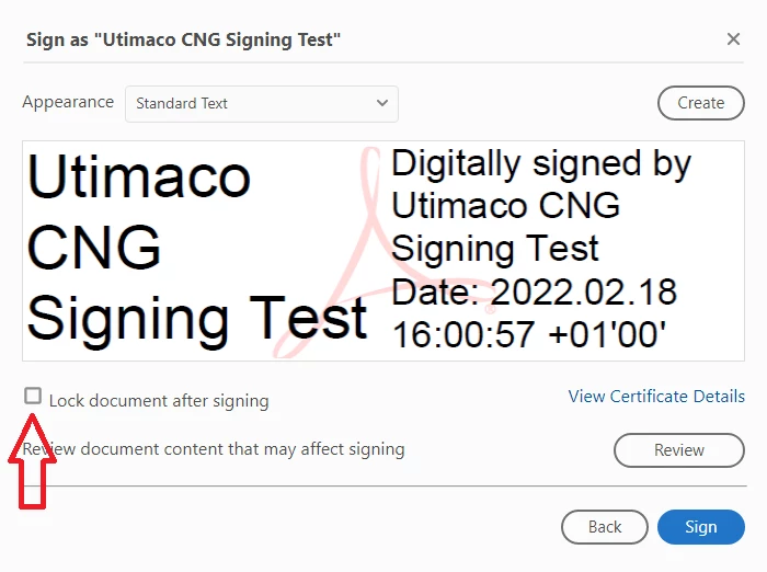

When signing a PDF, Adobe Reader offers that you can lock the document in the process:
Is it possible that in your multiple signature use case some signer has the habbit of clicking that check box?

If this indeed turns out to be the case, there might be a solution to prevent this: There is a signature field seed value LockDocument supplying the author’s intent for whether the signing dialogue should allow the user to lock the document at the time of signing. Depending on the signing software in use by the person locking the document it may suffice to set that seed value and the associated seed Ff bit accordingly in your form to stop that behavior.
