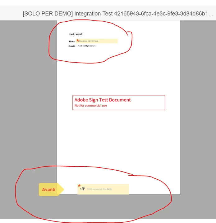

In this Pastebin you can see the request I have submitted: [JSON] Adobe Sign Sample Rest Request - Pastebin.com
As you can see, I pass a field of type "PDF_SIGNATURE" (that seems not supported by the API)
However, I received the email and if I open the link I can see that the  field for the sign with a certificate is present:

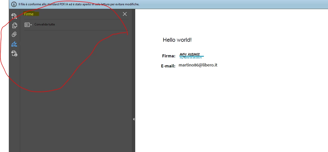

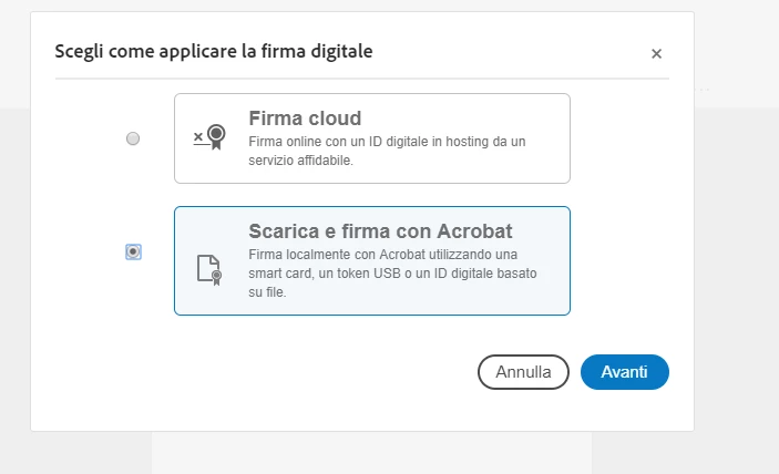

Then I select to download the file and sign it with a local certificate (sorry, the UI is in Italian)

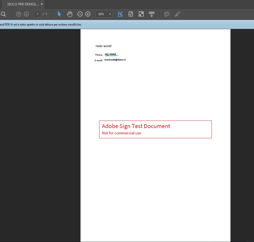

When I open the downloaded file, I can see my signature, but there's no more the digital signature field

Mostly the experience you describe seems expected, bar the last step i'm not sure about. If you open the pdf in acrobat and open the signature panel do you see your cert signature there
