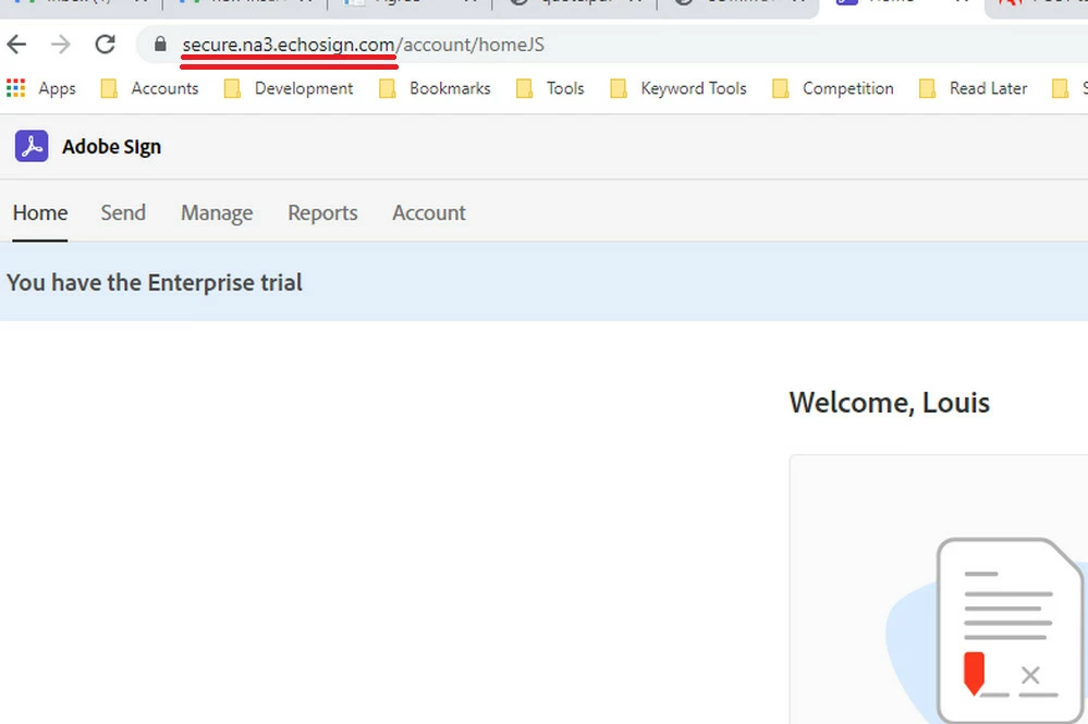

Hi Simon, thanks for your response.
The reason I am calling the api endpoint as https://secure.na3.echosign.com is because I've read that it should be the same as the url in my Adobe Sign account as you can see in the image I am attaching (url.jpg). But you are saying it should be https://api.eu1.echosign.com?
I am also getting 401 (Unauthorized)
any other suggestions please let me know.
