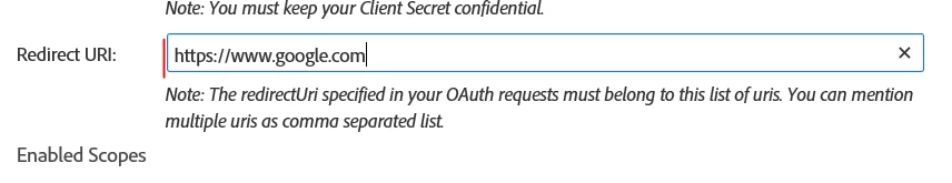

- The redirect_uri
     - If you dont have a website yet, yes Google is fine for now: https://www.google.com
     - Now very important, make sure that https://www.google.com (or whatever yours is) is also the same one written in the [Configure OAuth] section of your application! so that both request and application configure matches.
In your request, to match the configuration screen
redirect_uri=https://www.google.com

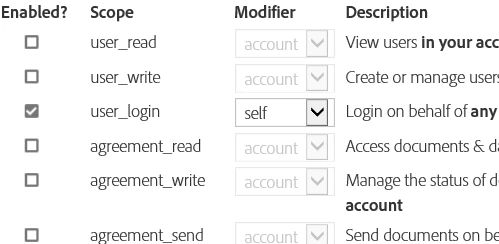

- The scopes!
As couple of people nicely said it, both your request string AND your application checked scopes MUST match.
So, for example here was my test application scopes
Only user_login:self is checked
So your request MUST be: scope=user_login:self

Next navigate to your Adobe eSign developer account -> Adobe Sign API -> API Application -> Select the Application you already setup for current integration -> Configure OAuth for Application -> Under Configure OAuth section -> Enabled Scopes -> Make sure all the scope values you provide in your API call matches exactly with the scopes (user_read) enabled here with exact same modifier (Self/ Account/ group).
If you are running into Unable to authorize access because the client configuration is invalid: invalid_request - fixing scopes & modifiers in url as per the Application API should resolve the issue following above steps.
