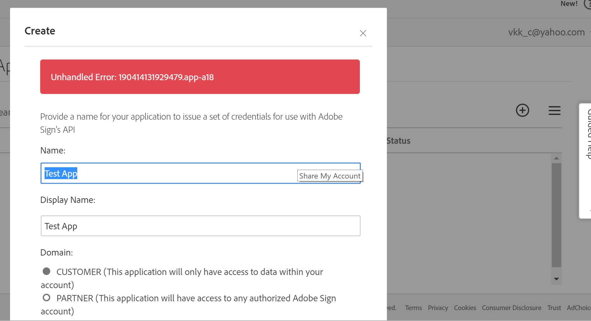

vaneetk1702836
April 14, 2019
I created a free developer account for Adobe Sign but not able to create an application under Adobe Sign menu option. After accepting application name, it keeps on throwing an error of "Unhandled Exception". Appreciate your help on the same
December 17, 2018
Meenakshi_Negi
December 19, 2018
Hi Abcda,
Could you please share the email address that you use to sign in to the Adobe Sign Developer account?
Please share the email address in a private message.
Refer to the steps mentioned here to initiate a private message How Do I Send Private Message
Meenakshi
