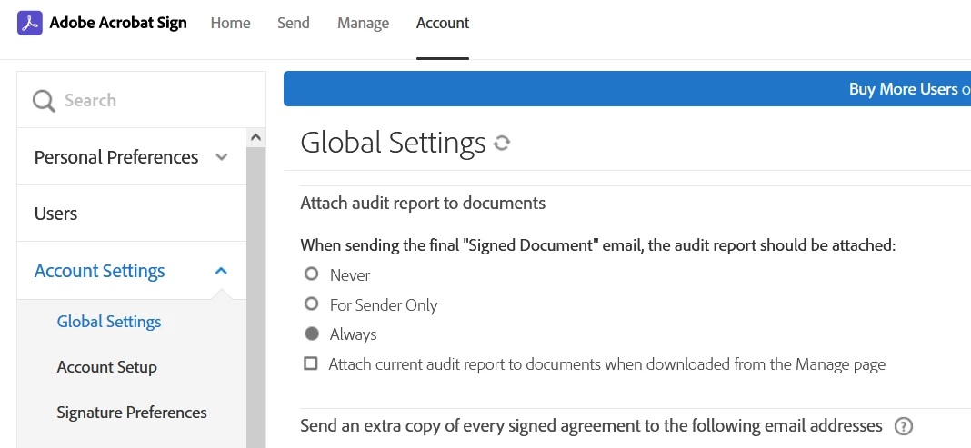

Bonjour,
Je voudrais savoir comment intégrer le rapport d'audit dans le document finalisé ; en effet, pour moi, seul le rapport d'audit constitue une preuve juridique solide que les participants ont bien signé.
Il faudrait donc que le rapport d'audit et le document soient réunis dans un même pdf insécable.
Merci de vos retours,
Meenakshi_Negi
Meenakshi_NegiCorrect answer
Apr 30, 2023 10:33 AM UTC
Hi Frederic29026342lmeb,
Thank you for reaching out.
There is an option to attach the audit report with the document. However, the setting is unavailable for the Acrobat Sign Individual level service plan. Check the screenshot of the settings for reference:
Let us know if you have any questions.
Meenakshi

May 3, 2023 10:28 AM UTC
Thanks for your answer. So I guess that with my subscription "Adobe Acrobat Standard DC" I don' have the option ? what formula of Acrobat should I get to have it ?
I am frankly disappointed by Adobe for this, I feel cheated. Nothing warned me that the Adobe Sign I subscribed for was worthless like that...
