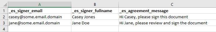

Hi Denise,
My first thought is that you don't have the header row on your CSV, or the email address header isn't syntactically correct.
But that's just a guess based on your observations.
The CSV you describe should look something like this (row 1 being the important one in this error case):
If the above isn't the issue, then you will want to open a case with the support team, and attach both the CSV you are using and the agreement file you are sending (if possible).
