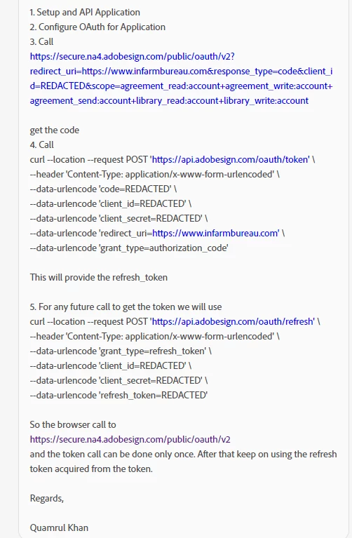

You are correct in that a login is required. however along with the initial access token you also get a refresh token. You can use this refreh token to automatically refresh the access token going forward.
The refreh token does not expire, unless it's not used for 60 days
https://secure.eu1.echosign.com/public/static/oauthDoc.jsp
Refresh tokens expire after 60 days of inactivity. In other words, a client can continue to use a refresh token indefinitely, as long as it is being used at least once every 60 days - otherwise it expires automatically. Refresh tokens can also be revoked by the authorizing user, so the application must be prepared for revoked access at any time.
September 3, 2021
Here where the step:

August 24, 2021
Thanks Meenakshi,
I was able to add mmself as support admin and create a case as per your reccomendation.
Quamrul Khan
