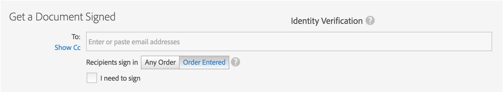

Hi Philip,
This is happening because you may have selected "Recipients sign in Order entered" while sending the document:
This option means, you want people to sign one after the other based on the order you put their mails while on the Send page. In this case, mail will be sent to the 1st mail address in the list and after he signs, it goes to the 2nd signer and so on.
If you don't care about who signs first, you can select 'Any Order' while sending the document and then everybody will get the agreement simultaneously and any of the recipients will be able to sign the document in any order.
