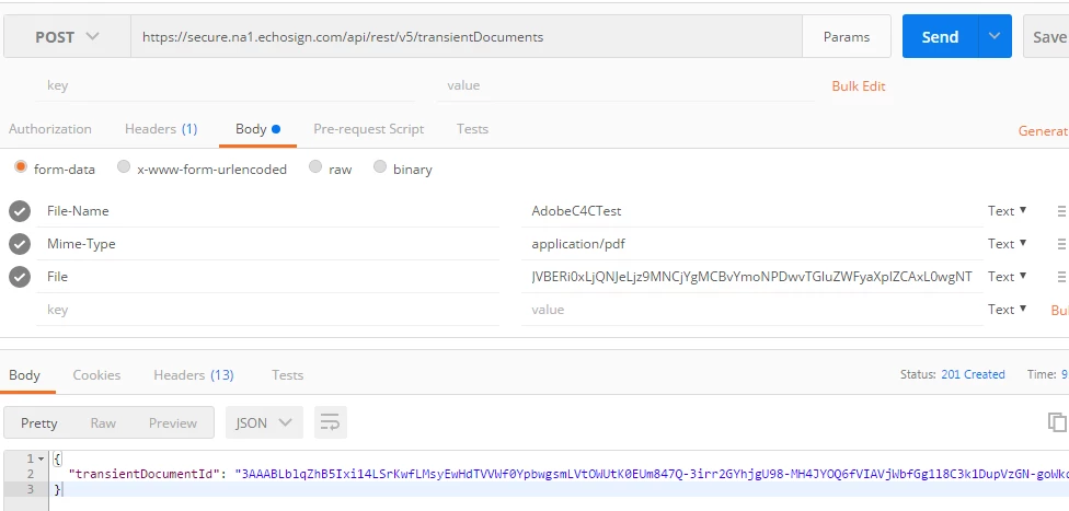

I'm developing connector for SAP C4C to Adobe E-Sign I'm using /transientDocuments rest method to upload the document using POST method.
While making connectivity I'm getting error message as  "Not Found Resource Not Found".
I'm using below URL POST request.
https://secure.na1.echosign.com:443/api/rest/v5/transientDocuments.
Providing Access-Token at header parameters and all other parameters at Body level and i have used JSON format to build the Body like below.
Body = "{\"File_Name\":" + "\"" + File_Name_Value + "\",\n\"Mime_Type\":\"" + Mime_Type_Value + "\",\n\"File\":\"" + convbase64 + "\"}";
I don't know in which format i need to build the body in SAP C4C SDK through ABSL scripting is it ok to use JSON format as above ???
While this is working as expected with the POSTMAN Tool as below
Kindly help in this issue.
