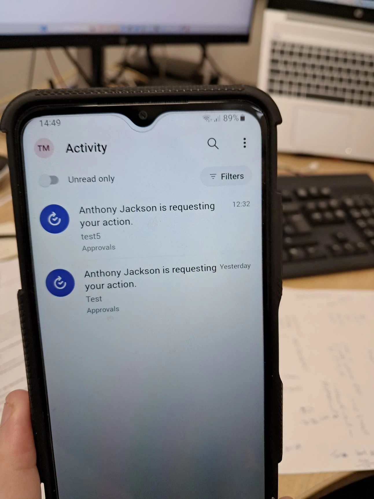

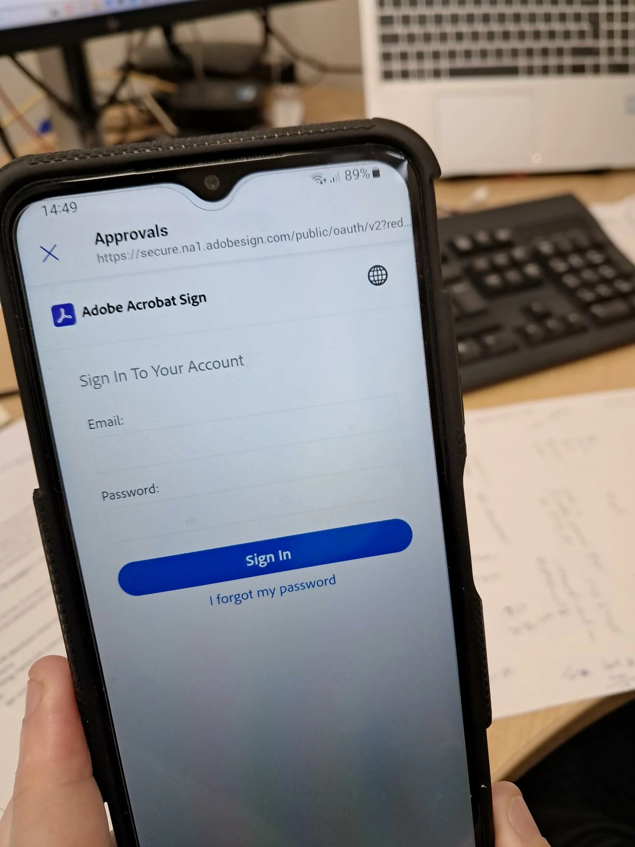

SteveB112Author
Apr 9, 2025 2:02 PM UTC
Thank you for your response. I have added the images below to demonstrate what is happening. The user is already signed into MS Teams and receives a message about signing a document. He clicks on it and is asked to sign into Adobe Sign.

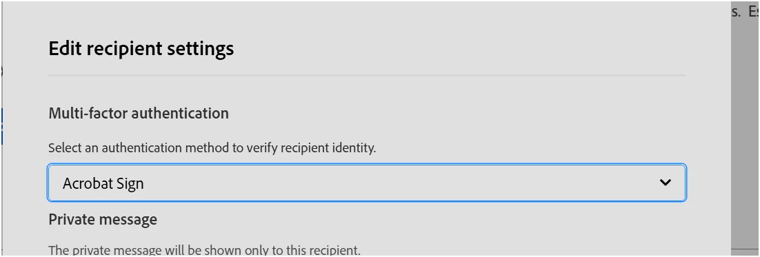

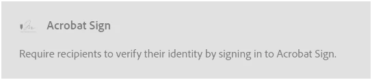

mariahweyne
Apr 9, 2025 4:23 PM UTC
By any chance did you ask for an authentication with Adobe Sign?
