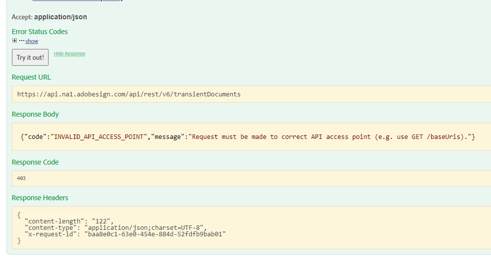

I had tried to upload a document through the TRY IT OUT screen with my authorised account, this also showing the same errror message, I think the issue may be related to my account, that have to do something additionly. Anybody have any idea about the issue?
Please help me.
Thank you

Hi TonySbnt,
Sorry for the delay in response.
Please try changing the request URL from https://api.na1.adobesign.com to https://api.in1.adobesign.com and check if that works.
If the issue persists, then I would suggest to get in touch with the presales team. They will be able to provide you the pre-sales technical assistance and share the right information.
Please refer to the following link to get in contact with them: https://acrobat.adobe.com/us/en/sign/pricing/plans.html. You may use the contact button for Adobe Sign business and enterprise under the Multi-User tab.
Let us know how it goes.
