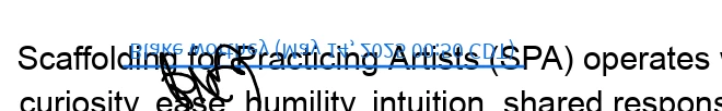

I have started getting an issue where a client is signing a document but when I get the document back, the signature is upside down and in the wrong place. Has anyone else had this issue and what can I do to correct it without having to resend to the client?

Hi - I'm having the exact same issue. I created a web form with a signature field that was working fine for months but as of yesterday all signatures are coming back backwards and in the completely wrong place when returned. I just tried filling out the web form myself and it's doing the same thing. How can I resolve this? And how can I fix the completed forms that were affected by this?

I am having the same issue on multiple doucuments. using a webform.   The first set of vendors who filled it out was fine them all of a suddon all of my webforms have every signature and initials upside down and in the wrong places.   I went to the webform to see if the locations moved for some reason and they webform is perfectm just anyone who has filled it out in the past month is upside down.  This is unacceptable and started happening right when they did the update to the new interface.   Please fix!!

It looks like the feilds we put in are getting flipped, like if the actual doument is flipped the signature will then be in the right place.

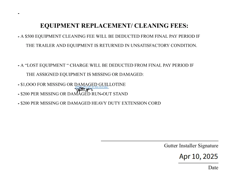

Apr 11, 2025 2:43 PM UTC
Please see the included image. The signature is not where the webform signature line was originally placed, and as you can see is flipped.

Having had a look at the internals of the PDF shared by @National Gutt38950863bk5c the technical cause of this issue appears to be that at the beginning of the page content stream there is an instruction to flip the direction of the y axis for coordinates in the remaining content.
This flip is considered in the regular content thereafter. Quite likely the flip has been introduced because this regular content has been designed with that flipped coordinate system.
The signature applying code, though, apparently has been designed with the normal coordinate axis direction in mind and does not realize that there is that flip when appending the signature to the content stream.
As a result the signature is displayed upside down and at a wrong location.
