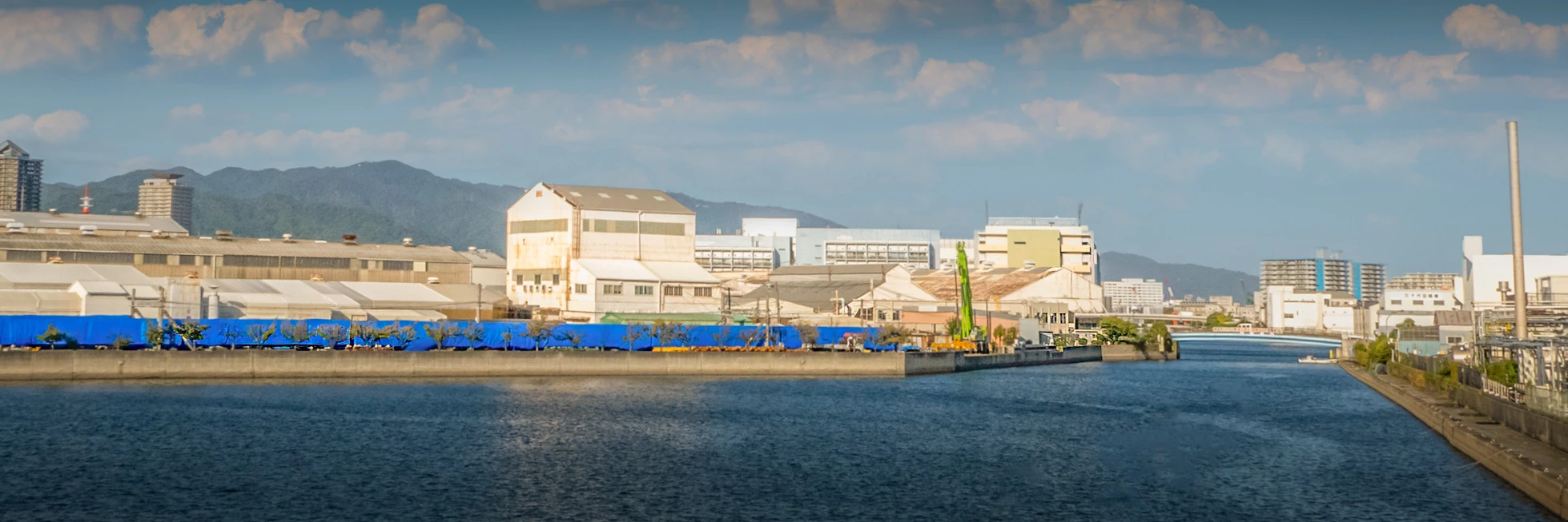

adobeフォトストックに風景写真を提出しているのですが、
多くの写真が「品質の問題」により却下されます。
品質の問題で却下された写真をいくつかUPさせて頂きますので
どのような問題があるのかと改善方法を教えて頂けないでしょうか?
よろしくお願い致します。
以上

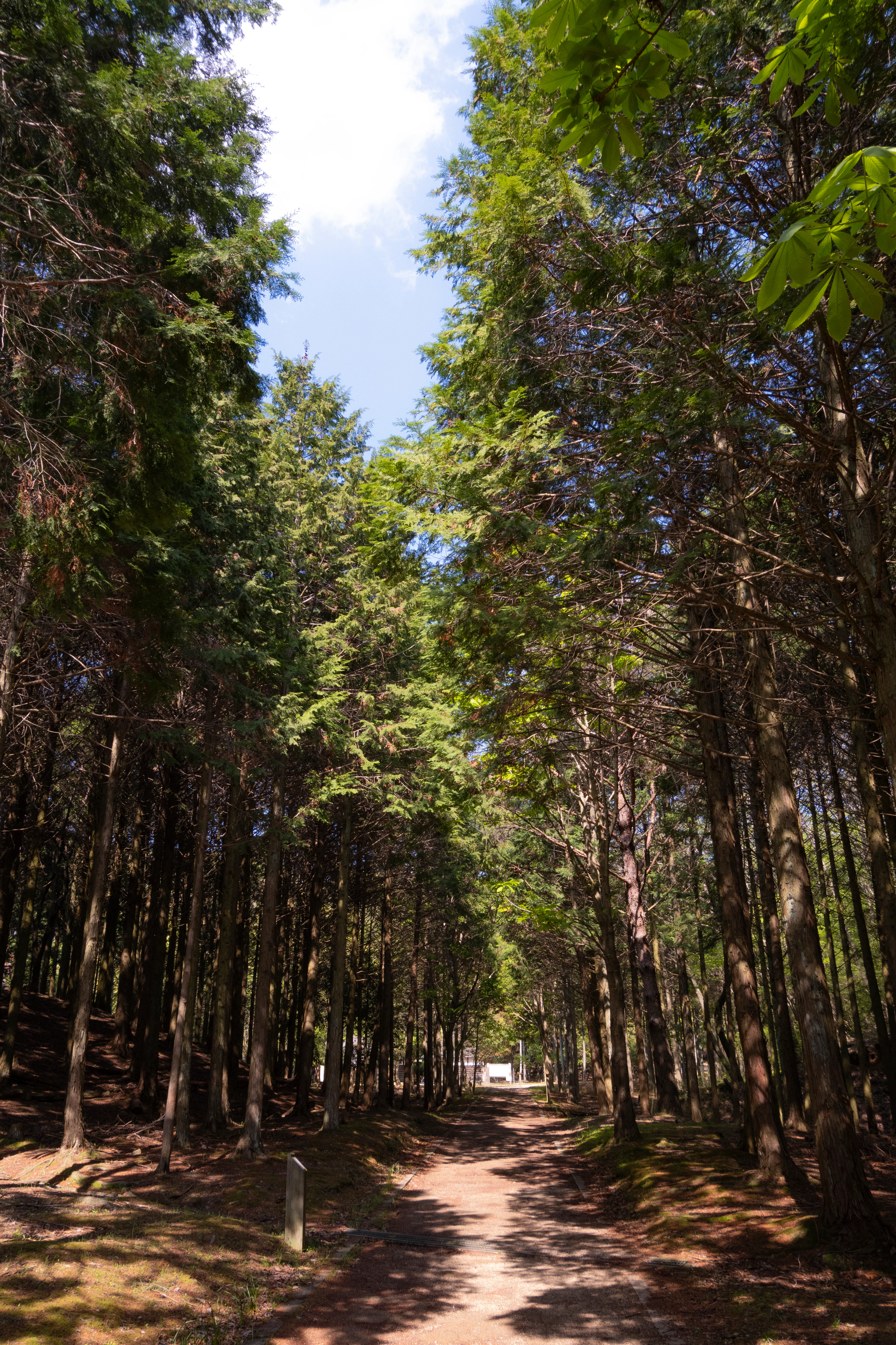

ap_20254029_A7 (24).jpg - very underexposed in the shadows

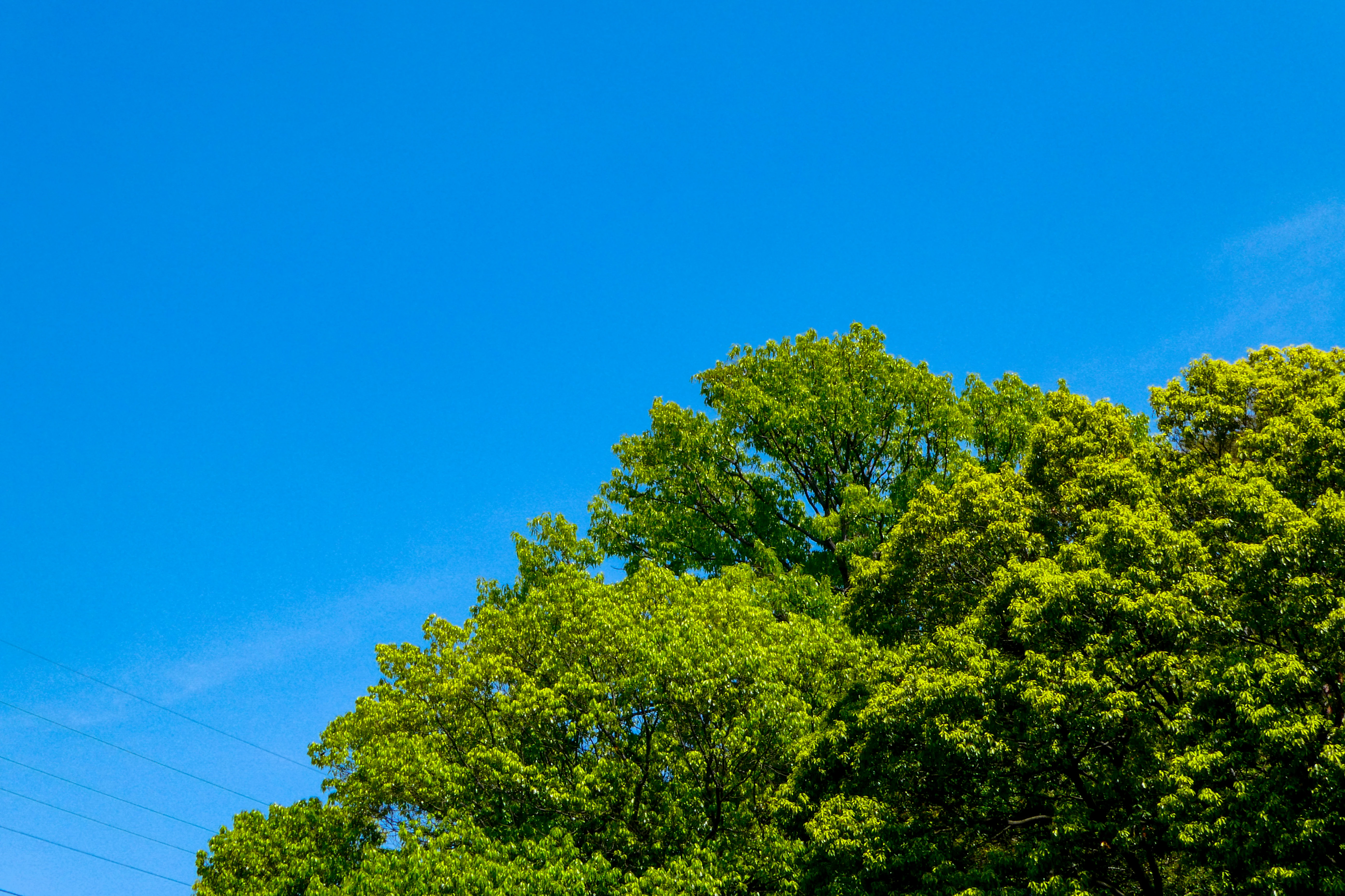

All of your photos need post processing.
I see errors like unlevel horizon, underexposed shadows, overexposed highlights, unwanted objects (such as wires on the photo of a tree) and cropping issues.

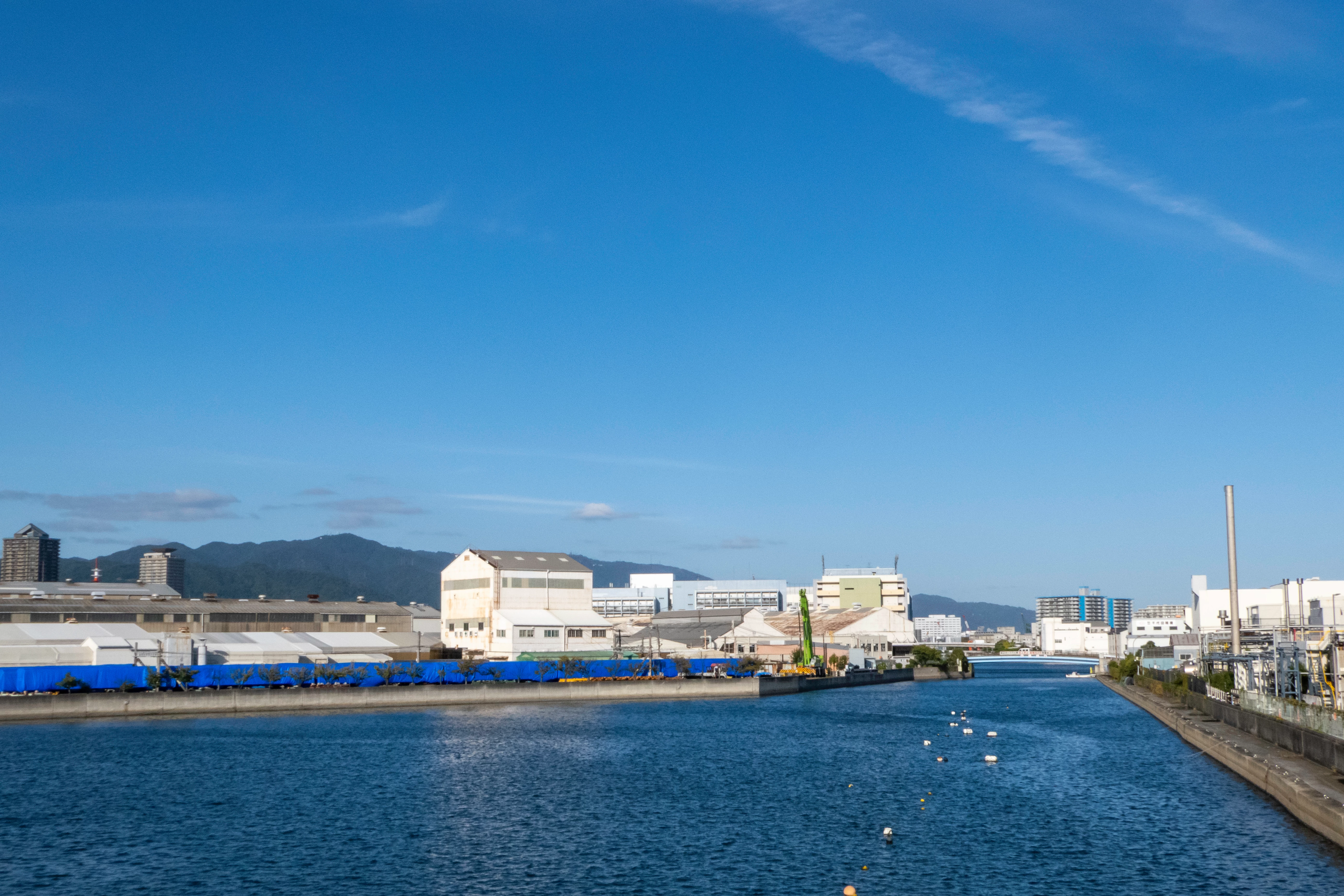

Your first: It's a nice picture, but you need to augment sharpness (focus?) and reduce the noise. Reducing noise is possible if done carefully, but correcting the sharpness is difficult. It is not easy to correct a picture that is lacking sharpness out of the camera.

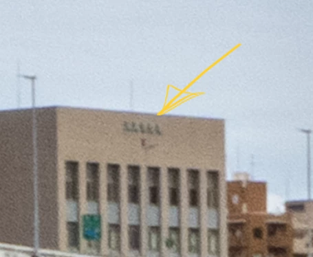

In addition, to avoid intellectual property refusals, you need to edit out logos and company names like here: :

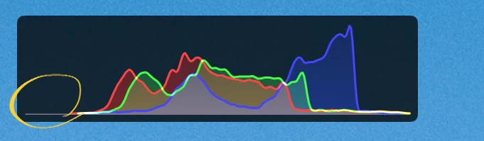

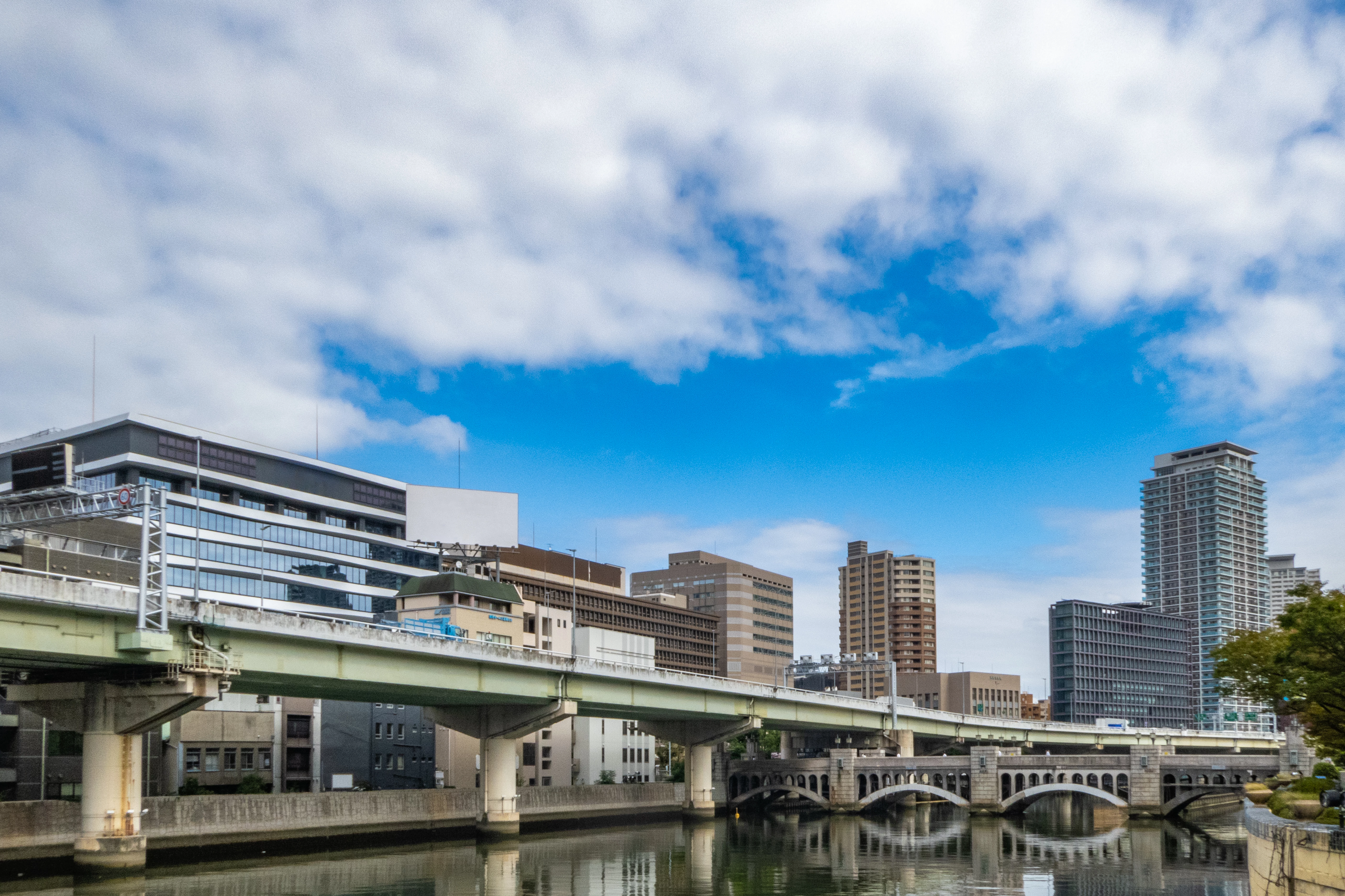

Your second is oversaturated, especially in the blues, and has an exposure issue, as shown in the histogram:
Your third: oversaturated and noisy. I did not check the exposure or any other possible defect.

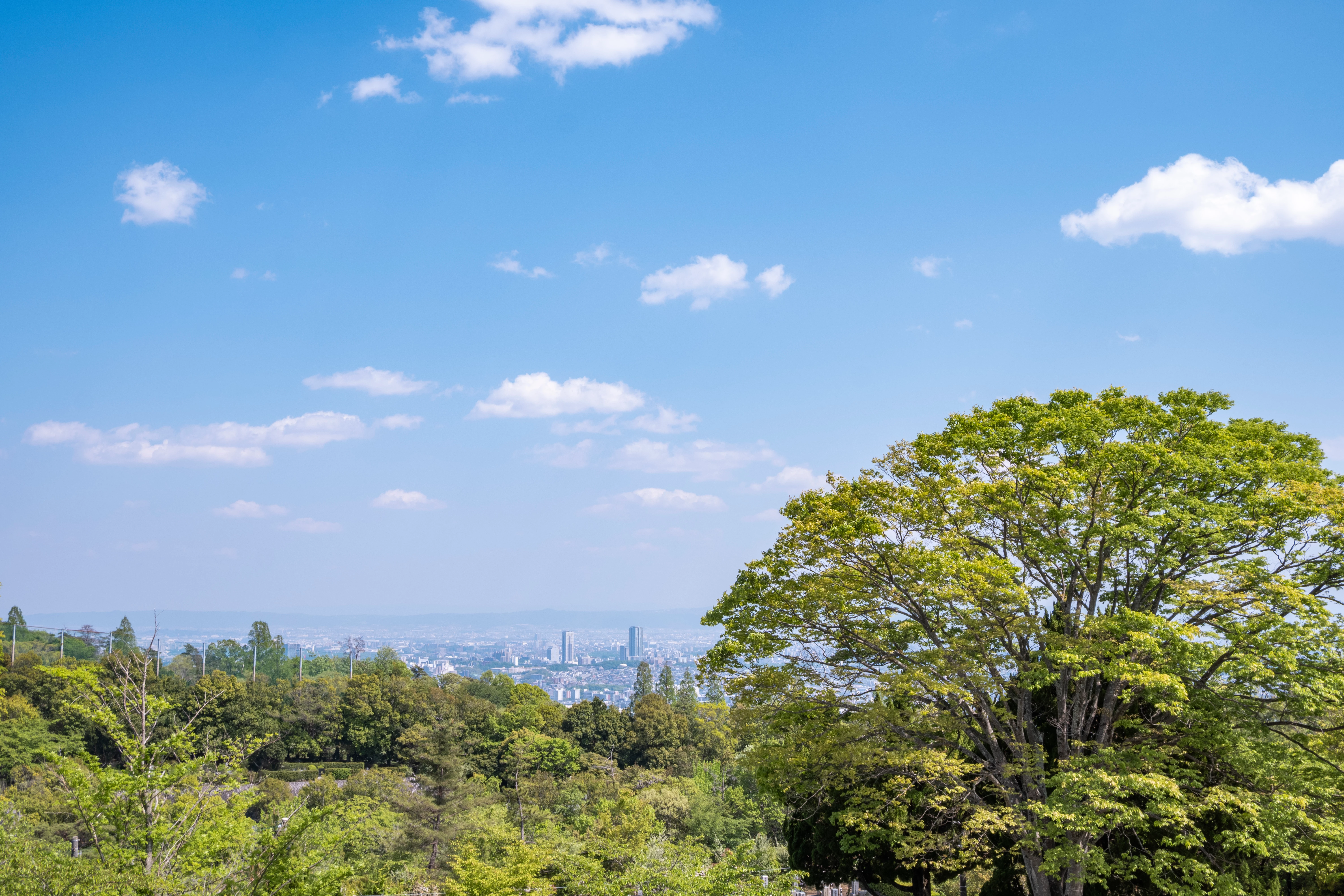

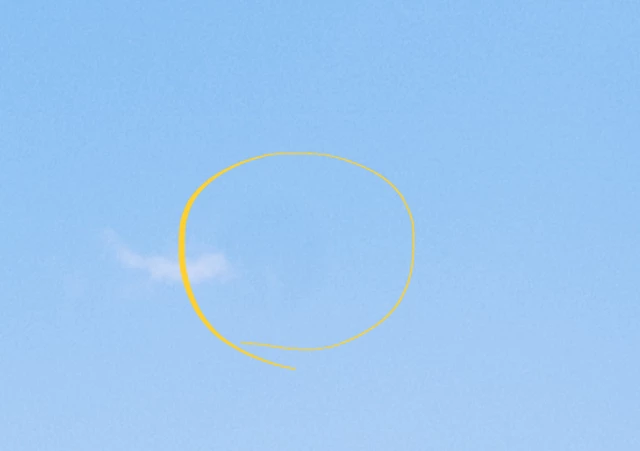

Your fourth: Sensor dust:
(When you know that you have a sensor dust issue, you can easily correct that. If you have multiple issues, you will need to clean the sensor.) The picture is also missing contrast, and you could enhance the texture/clarity. Be careful, not that you add or amplify the noise too. Be careful, not that you add or amplify the noise too.
