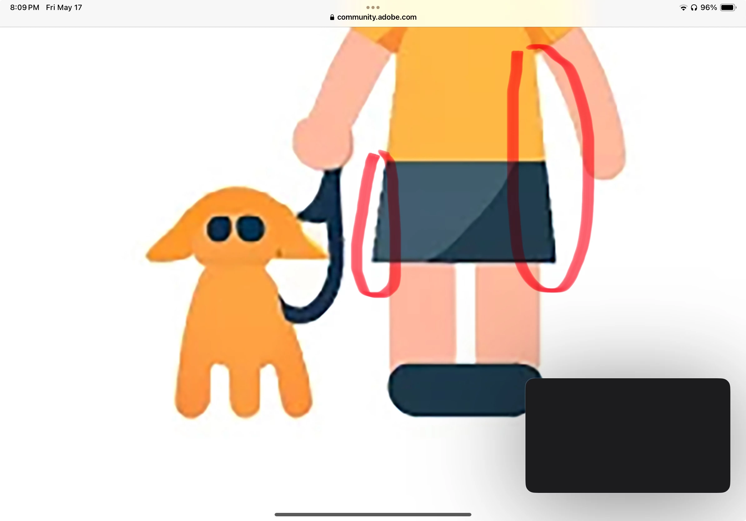

添付画像のような様々なAI生成イラストを約50枚審査しましたが、全て「品質の問題」により却下されました。
AIによって生成されたイラストはphotoshopで解像度を高くアップしています。
何を改善すれば審査が通れるようになるかアドバイスをください。

A lot of weird shapes that don't make sense, croocked lines that should be straight. I haven't circuled all the issues but they are easy to spot at 100%. Seems we're seeing more and more Illustrator AI images that contributors assume are turning out perfect results. They're not. These need a lot of point-by-point editing after the fact.

The person in your third image looks overly synthetic with an irregularly long neck.  Everything about her is weirdly disproportioned.

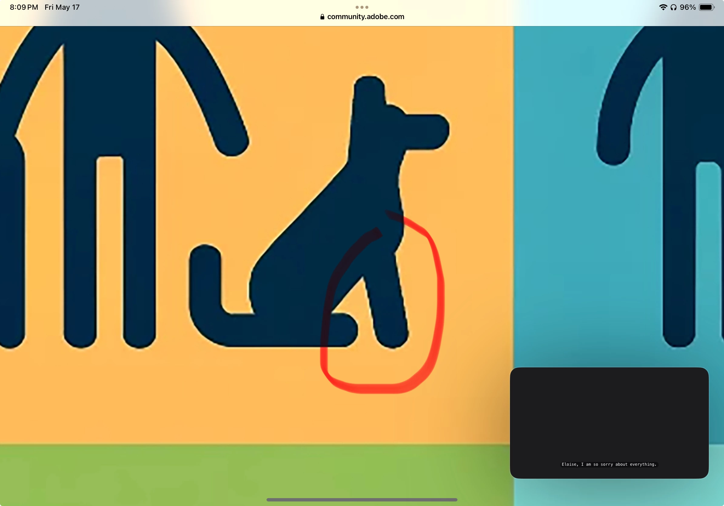

イラストアイコンについても「品質の問題」により却下をされてしまったのですが、却下の原因についてわかるでしょうか。

Zoom in and inspect carefully. The lines are jagged and poorly drawn.

I suppose you did not check for the typical generative AI errors. Which proves, by the way, that you did not inspect your pictures at 100%. Generative AI is getting better, but it is still bad with some things, like hands, faces, geometric objects like knobs etc.
Quality requirements for AI and Photos are the same, but AI introduces other errors. You need to look for those before submitting.
