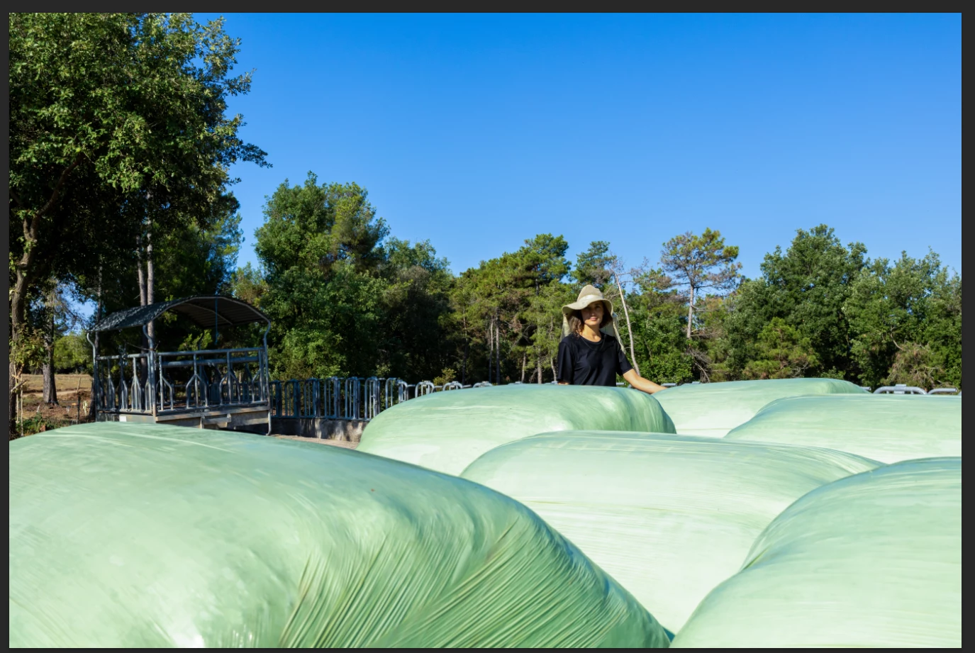

Hola compañeros, me han rechazado como unas 18 fotos del segundo envio de una sesión, el anterior envio todas aceptadas, os subo dos imagenes para que me digais que puede ser porque no entiendo nada. saludos

Your photo of the girl standing next to the hay bales is too yellow. The light reflected from the bales (as they are yellow) has given a strong yellow cast. This has to be reduced in post-processing. As she is wearing a hat, this has caused her face to become darker, so you need to lighten the shadows and try to bring more detail to the face. This can be down by using fill-in flash and a reflector.

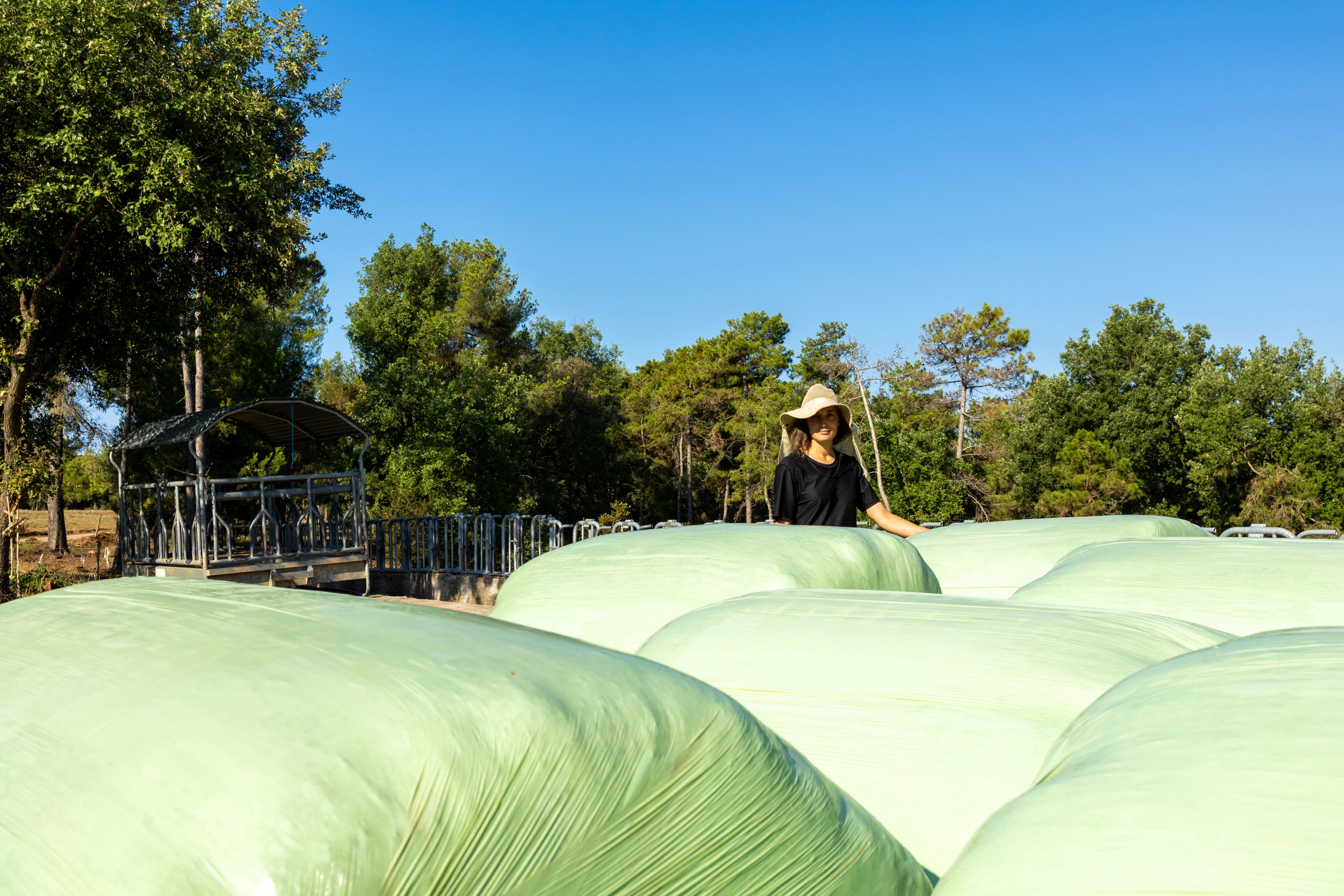

Similar to the second photo. The face is too dark. You can bring more detail to the hay bale covers by reducing the highlights. Perhaps think about using a polarising filter, which helps to reduce glare and reflections off shiny surfaces.
Quick example:
However, in both cases, if you shoot in bright sunlight and the person is wearing a hat, you need to make sure the face is light by using reflectors and fill-in flash.

Your first: issues with the white balance, the straw is partially overexposed, the models face is not good lighted. You would have needed using a reflector to get the models face correctly lighted. The whole looks like a nice vacation picture of your girlfriend. If you want to illustrate the farmlife, she should not stand there and smile into the camera, centered in the image.
The second picture is a bit the same, too much shadow on the eyes. You need to improve your storytelling, if you want to sell that the model is a farmer.
Both images have a considerable noise level in the shodows.

The first image has some blown out spots. The second image has underexposed shadows.

I'd remove the model. She appears more like a distracting prop, while the real subject is her surroundings. To put it another way, both images come across as keepsakes from a recent vacation. Does that make sense?

Seeing only these two separately it could be, but seeing the whole session you understand why she is a farmer of organic cows. Thank you.
