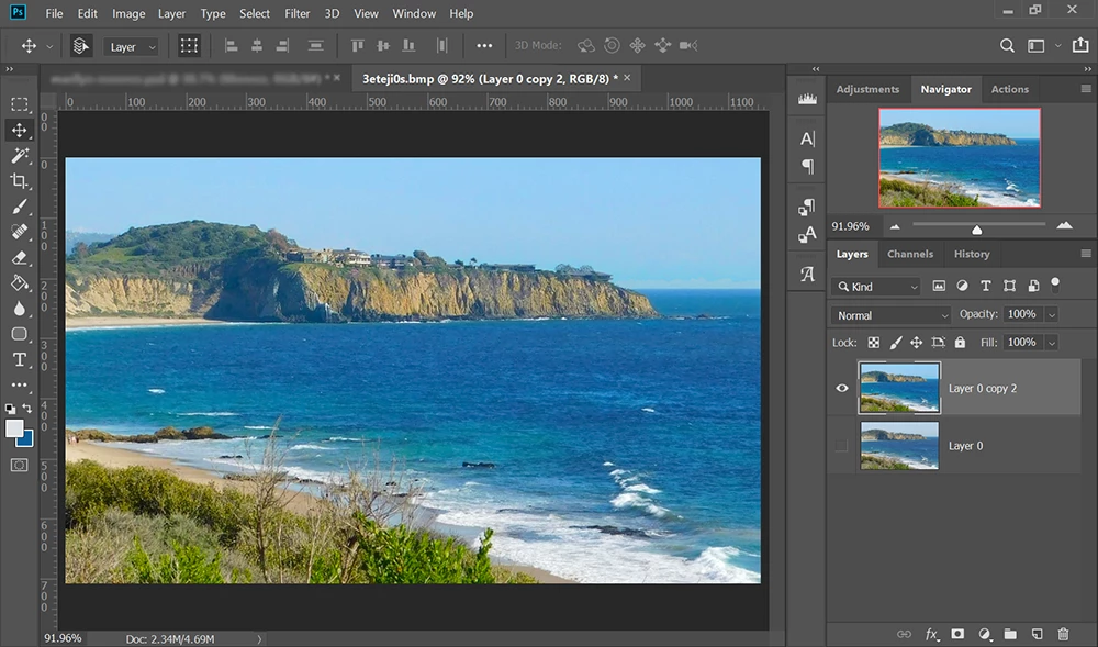

I don't mean to be overly critical but this composition lacks much WOW factor.  In the absence of any boats, people or colorful kites to bring life to it, the water and cliffside homes are the main subject.  Crop this tighter, boost vibrance and add a touch of sharpening to the cliffside.  Also remove any unwanted noise.  Combined, I think these adjustments will give it more visual appeal.  My quick example is a little oversaturated but you get the general idea.
