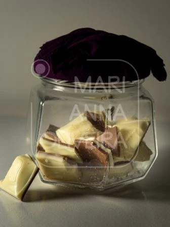

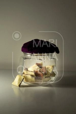

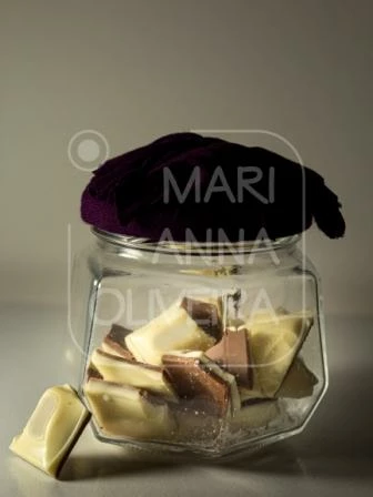

Help-due to 1 or more technical issues my photo was rejected
What technical problems does my image have, can someone help me?
Please suggest what's wrong, this is my first time in adobe stocking. Thanks!
I sent without the watermark
Logos/watermarks are not allowed, but perhaps you put your marks just on these images which you've submitted for feedback. Since the image is not high resolution, it's not possible to zoom in and inspect closely; however based on observing the size you've supplied, I would say that the focus is not sharp enough, the images are underexposed, the object on top (what is it?) is definitely underexposed and shows some fringing. Additionally the background shows many artifacts, perhaps noise from a high ISO. Also the horizon line in the background is not level. This could have been avoided by using seamless paper for the background.
