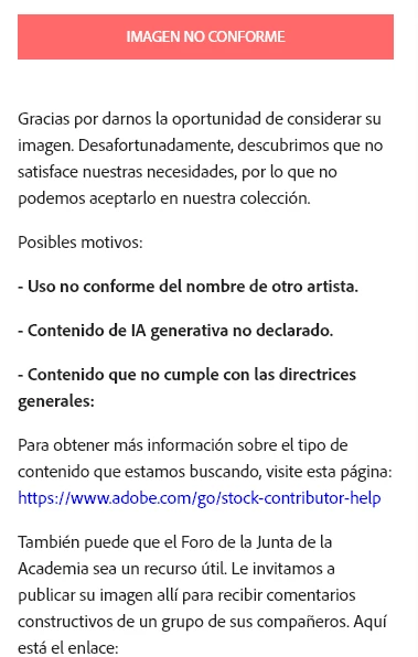

I do not accept this from Adobe, it is a lack of respect towards the creator
Hello, because Adobe Stock tells me that it is created by AI, if it is not, it was created from 0 from an image that is happening. Maybe they no longer believe in one's potential. It is a shame that this platform thinks that it is generated by AI, something that It is not like this

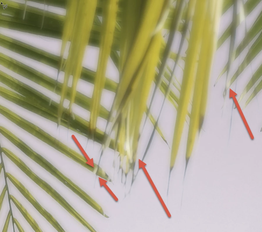

As for your asset, see below for some errors (all screenshots at 100%)

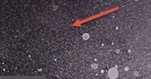

Noise or other artefacts:

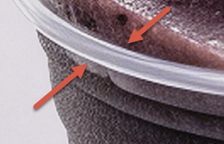

Aliasing:

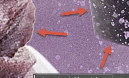

These cutouts are terrible, as you see immediately the errors:
(white border, hard lines, in addition very artificial cut lines for the lower part of the goblet)
Washed out colours and strange artefacts.
In all circumstances, this asset has earned a refusal. I don't understand why the moderator told you that the image is non-conforming, but there are many general requirements you can violate, like keywords. It may also be that the moderator considered this as a bad generative AI asset. It does not exactly look like an AI asset, as there are plenty of errors, that are inconsistent. Your cream looks like scanned from a newspaper. The palm sheets look like an overprocessed smartphone image. The ice cubes seem like simply pasted into the image, especially the one I pointed out (this screenshot is at 10%):
I would have rejected this asset on the grounds of quality. But the moderator may have seen a keyword, that was wrong, or they may really have thought at the first sight that this was an AI asset. Or they may have chosen the wrong refusal reason. Whatever it is, the refusal is rightfully granted.
Aliasing:

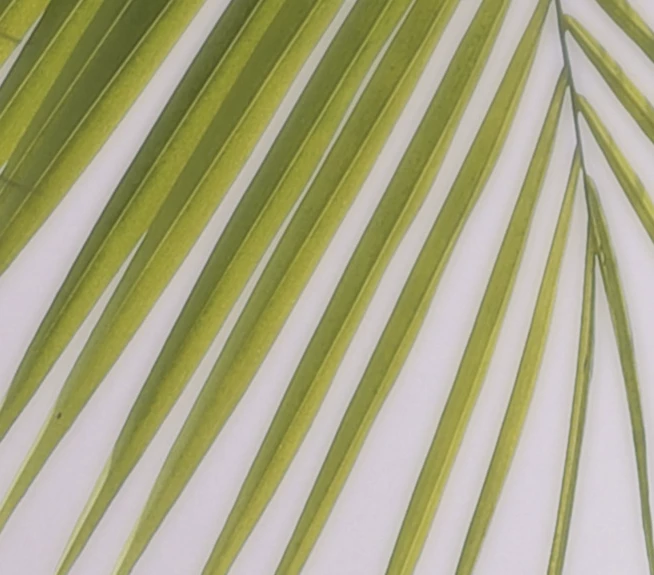

1.  Don't be a snowflake.  Stock refusals aren't personal. It's a generic refusal letter.
2. Read the Stock Contributor User Guide where Noncompliance is fully explained.
3. Critique:  The spots on the cup look like artifacts.  The ice cubes don't look real.  The white balance is not neutral. And the palm tree leaves look diseased.  If I were the Reviewer, I would have rejected this image for technical/quality reasons as it's not commercial-ready for use.

Maybe I was confused. I was under the impression that the image was accepted, but then labeled as Generative AI.
George_F
Mar 2, 2024 5:12 PM UTC
The OP posted a screenshot of a Non-Compliance rejection in another language above.

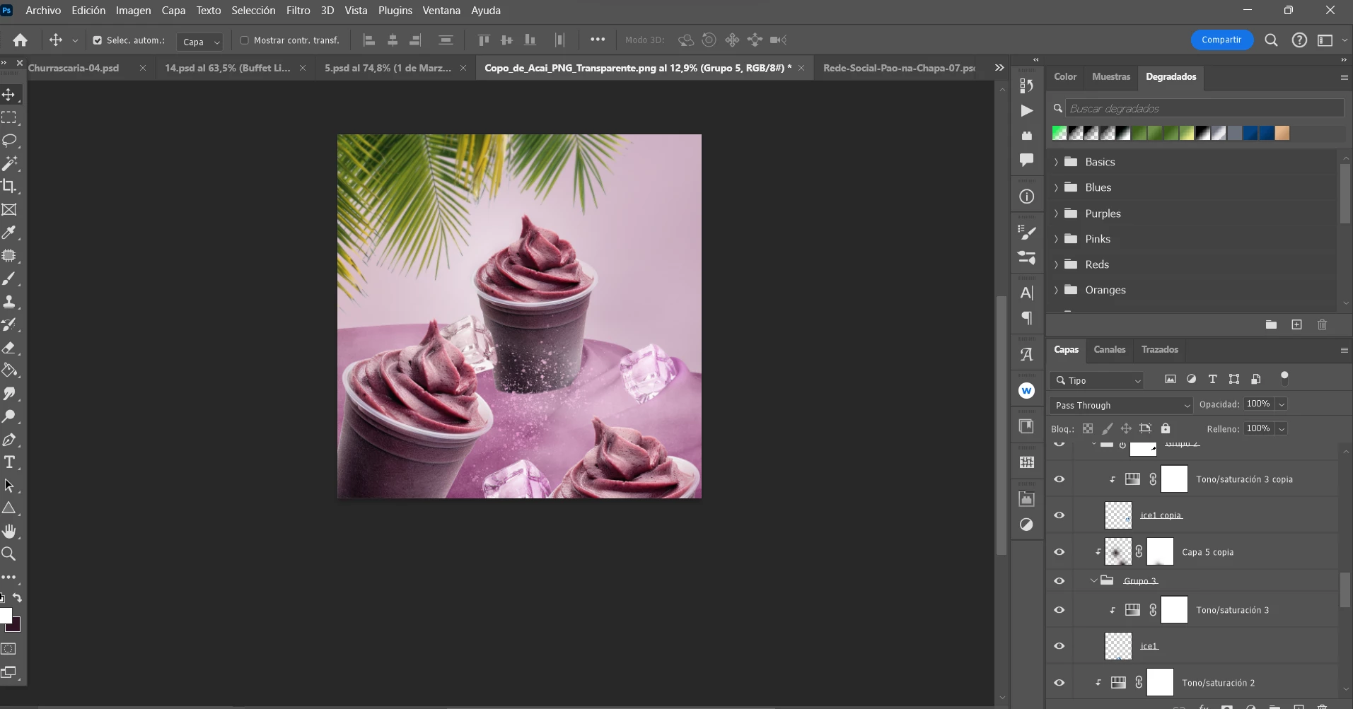

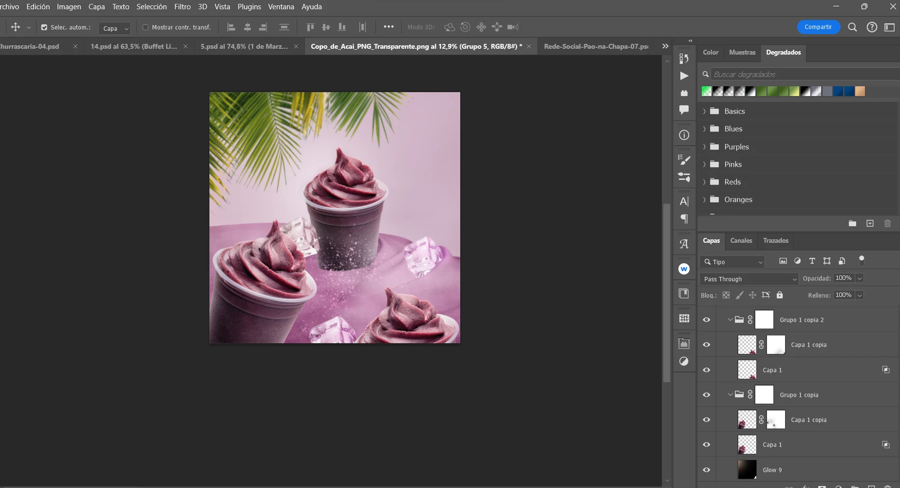

It definitely looks like a Generstive AI image, though from the layers label you have provided I can see that it was created in Photoshop. It's not a matter of Adobe being disrespectful to Contributors. There have been and continue to be many submissions on which the contributors fails to identify assets as created by AI. It is the Moderstor's job to protect the Buyer and ensure that they can license high quality, properly identified assets. Unfortunately, there's no way to dispute the findings of the Moderators. You can send a request for review via the Contact Us link on your account page, though they may not answer since it is generally their policy to not engage with Contributors on rejected images.
