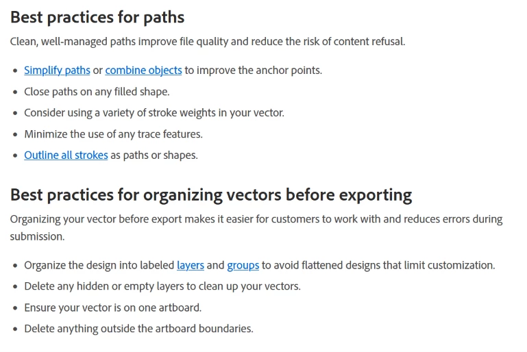

    Sep 18, 2026 10:16 PM UTC
    Pay particular attention to Vector Best Practices.
    Sadly, too many contributors gloss over these important details and submit unusable content.  It comes back to bite them later when customers complain & request refunds.  Check your work like you’re a buyer, not a seller.
