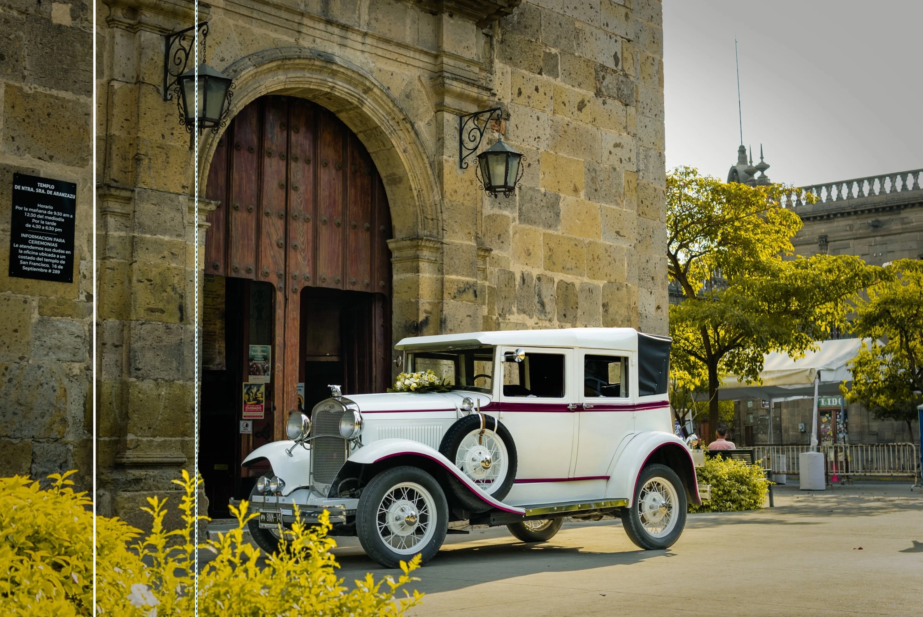

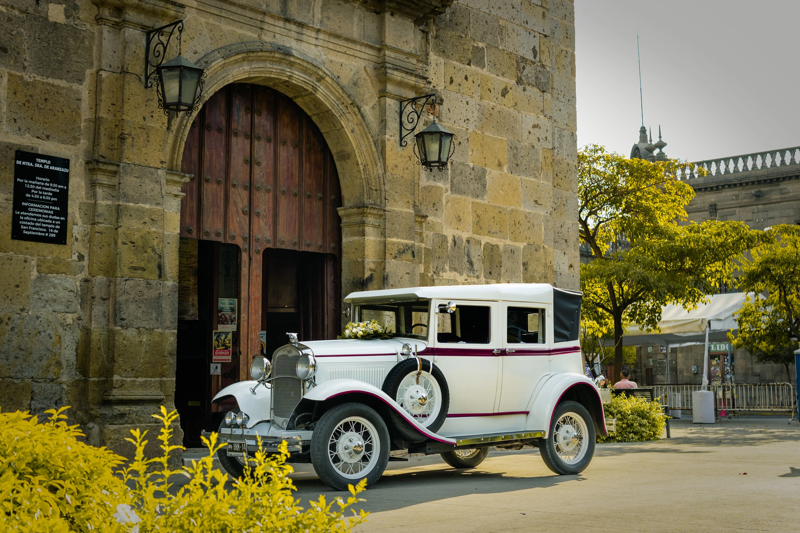

I would like to know why my photo was rejected
On this photo, I wanted to keep focus on the car and the church they are the main actors, others elements are not relevants. My photo was rejected by lack quality and I noticed that the trees on the foreground and background does not have focus, is it the issue? do you see other issues?
a per your experience, when we are capturing photos, we need focus on the foreground and background? if so, we need to use a small aprture? on it photo I used F4, I should chage to smallest aperture? thanks in advance

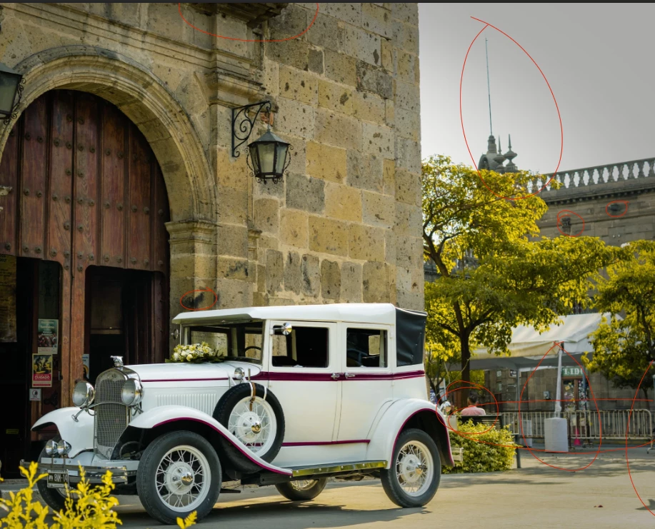

    1. The owner of the antique Bentley will need to sign a Property Release. Without a signed release, this image can’t be sold on Stock.
      https://helpx.adobe.com/stock/contributor/help/ip-guidelines.html.
    2. Examine your image with the Histogram Panel in Photoshop or Lightroom.
    See below for other IP violations, marked in red.

    Blownout sky, chromatic aberration, leaning verticals, and various IP issues…
    Jill C., Forum Volunteer

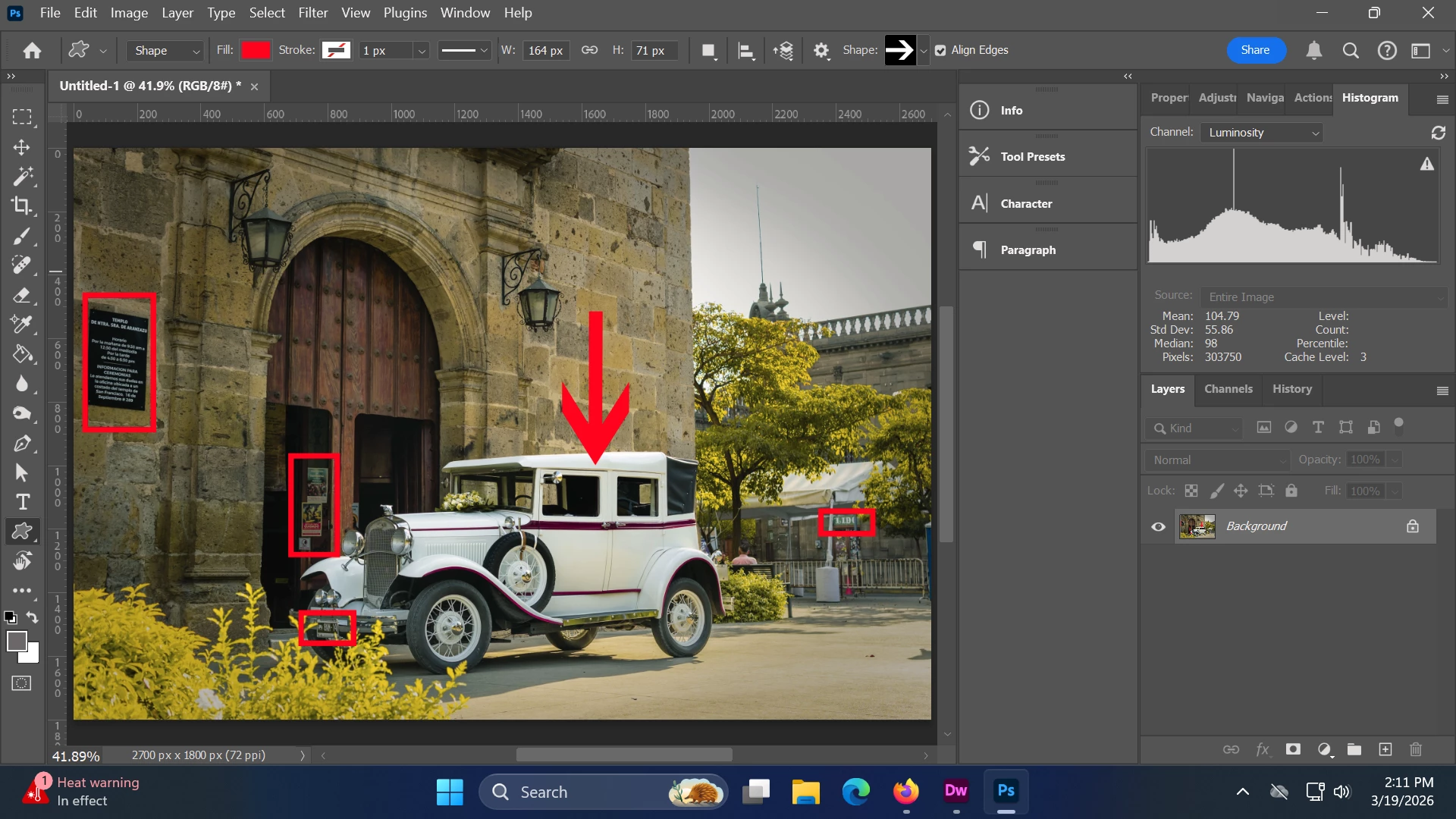

    Hey ​@MartinBarrigaFotografia
    I highlighted a few things that you could remove to help focus the viewers attention.
    Photoshop has the capability to remove these distractions.
    Cheers

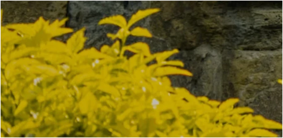

    Your photo is underexposed. It also has chromatic noise (color fringing)
    In addition to the identified quality issue, there are also IP issues. You need to remove the car license information and also the sign info on the wall and store names.
    You need to zoom in on your photos at between 100 and 200% to find issues.
