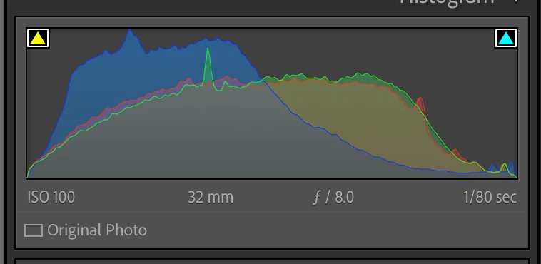

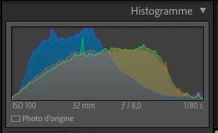

Thank you. But this is my Lightroom histogram

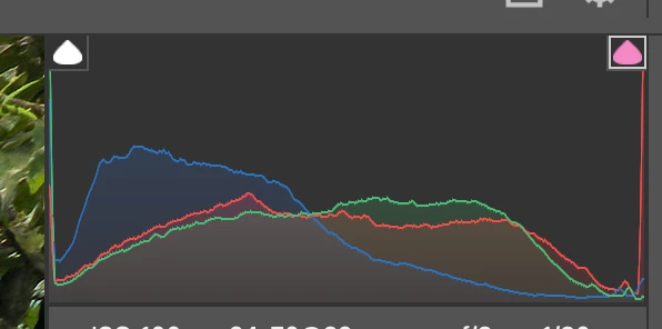

And this is what Lightroom shows for me, with the shadows and highlights still needing some attention. As for the descripency, maybe @Abambo can chime in. He understands histograms far better than I do. In any case, one doesn't need a histogram to notice the over-saturated reds. In fact, they register as R: 255 with the dropper tool.
