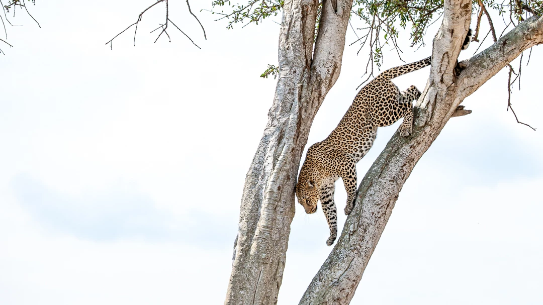

Leopard in high-key

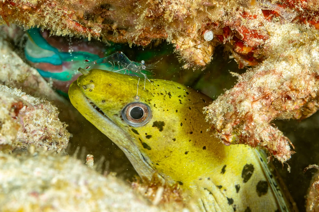

Moray eel

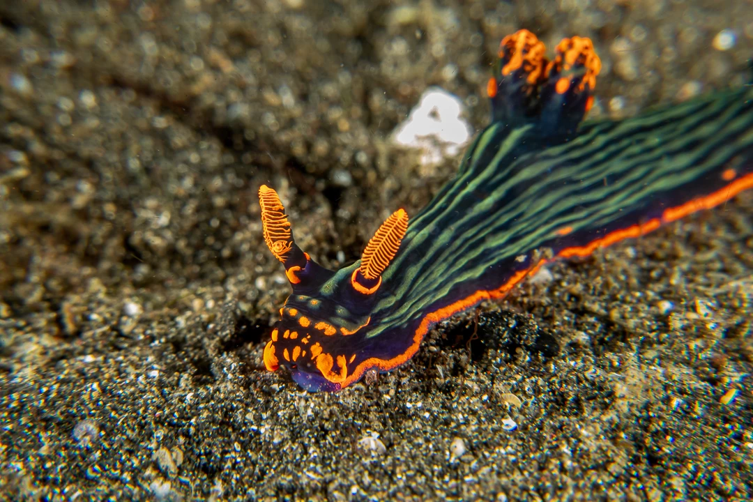

Nudibranch

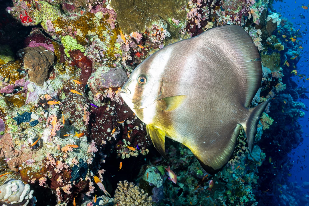

Batfish

    The 4 file you post have genuine quality issues.
    The first file has a white balance issue. It is a bit cool.
    Too much of the second and third files are out of focus. As a result details are lost.
    The highlights are too high for the fourth file. That file also has a white balance issue. If you look closely you will see a blue tint mainly concentrated around the edge of the subject.

    The good think of discuss with more people is that some details I didn't see were pointed out: the white bands of the Batfish overexposed, branches on the top border of the Leopard picture to remove… all good points.

    In the third image (orange creature), remove the blownout spot and resubmit.
    Jill C., Forum Volunteer

    let’s take the Jaguar image.
    Potentially there is commercial value.
    I would remove the strangling branches, do something w the sky, and find a way to make that Jag pop!
    It is a cool image.

    Thanks and sorry I made some mess: this is not the best answer.
    Well, the Leopard was badly backlit and this lead me to make the picture in high key.
    I think the shape of the animal and the tree pop up pretty well particularly because the back is very clear and white.
    Yes, probably removing some branches on the top border would have been an advantage

    Though it appears that the cat is properly exposed, the entire image reads as over-exposed due to the bright sky. That’s easy to fix.

    The highlight on the fish is overexposed - it won’t pass - and some other distracting objects.
    Composition is important, but I understand that taking a photo into a fish tank is not easy! And hard to get the right composition, but you do have to be careful of the background and try to get the exposure correct. Also, be careful of your depth of field.
    Luigi_CAuthor
    Oct 21, 2026 2:53 PM UTC
    Yes, I could have retouched a bit the white of the highlights…
    About the depth of field, often some areas (foreground) are blurry to enhance the main subject

    Overexposed highlights (blown-out highlights)
    Composition
    Focus that is too shallow
    Luigi_CAuthor
    Oct 21, 2026 2:57 PM UTC
    you're right but the system does not allow too big images: I had to reduce
    Are you talking about the Batfish? Frankly I don't see big issues of composition and the fish (eye) should be on focus. The rest of the picture should be blurry to enhance the main subject.

    In the image of the sea slug, there is open space in front of the subject, but the rear is cut off, making the composition feel incomplete.
