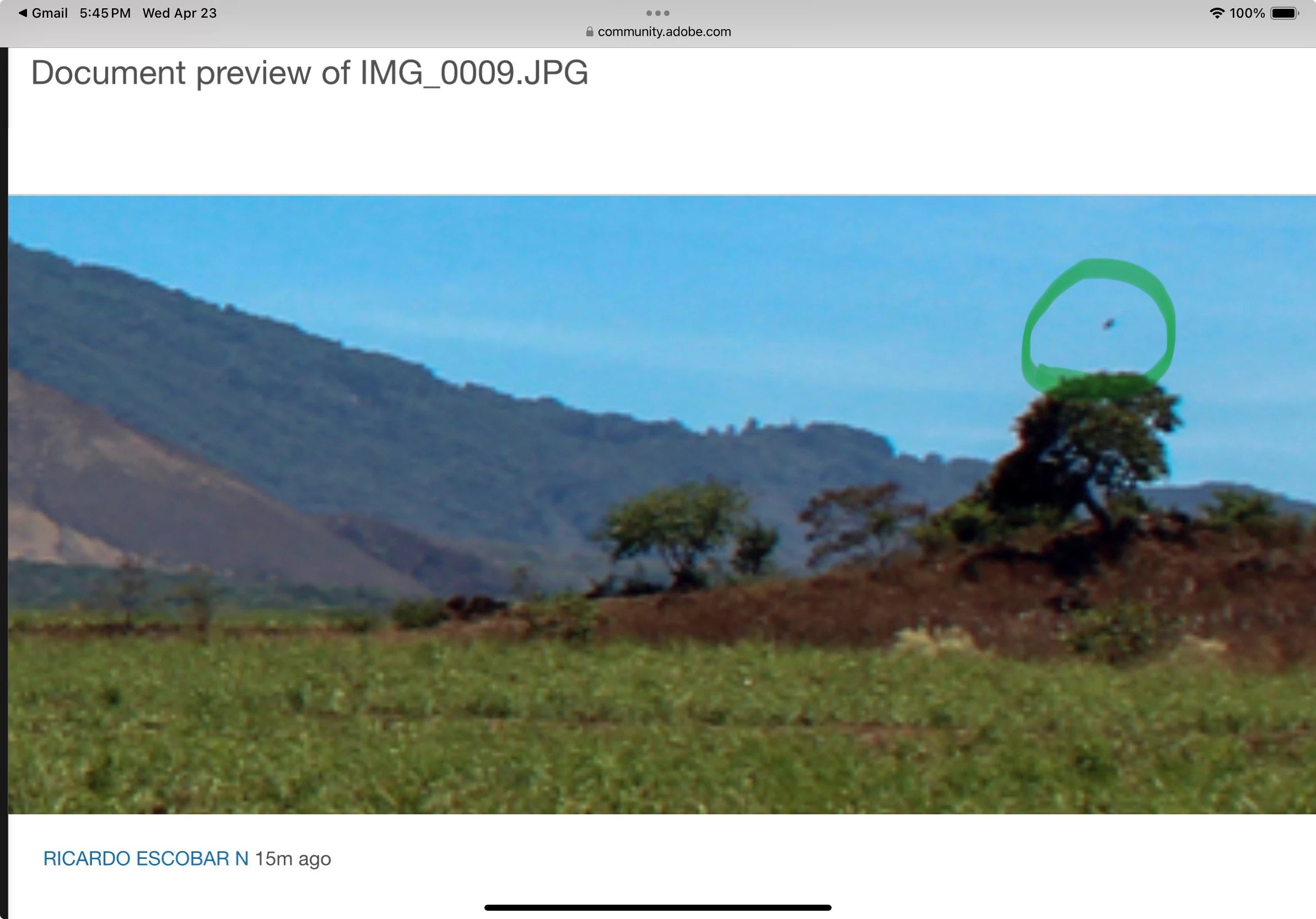

Focus seems to have fallen on the grasses in the foreground rather than the midground, about one-third of the way into the scene, which is preferable for landscape images. There's also an object in the sky that needs to be removed. I would have removed the fence post also.

Con respecto al objeto en el cielo, sinceramente no me percaté de él y al observarlo ahora que me lo indicas, deduzco que es un ave, y supongo que como no se distingue bien, lo mejor es eliminarlo.

Yes, it is perfectly okay to remove distracting elements in your photo. I regularly remove trash cans, power lines, poles, people, trash, etc. I'm sure that the object in the sky is a bird, but because it's so blurry it's better to remove it,
