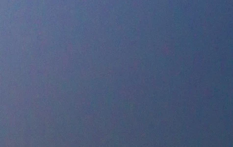

What ISO were you using? Because your image is fairly noisy. I mean, I can see the noise even in the inline version. Clicking on it to view it full size really shows the noise. See?
This section of the sky (from the bottom-right) should be a fairly smooth gradient, but it's all noisy.

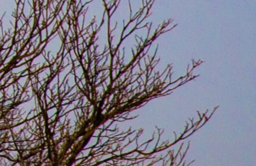

Also, look at the branches specifically. There is a lot of chromatic aberration or something.
Green and pink around the edges like crazy.

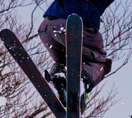

The snow has lots of contrast, so well done there, but the skier seems under-exposed and yet still noisy.
Look at him or her at full size, very noisy.

Hey Szalam, thanks again - that's really helpful feedback, you're exactly right.
The image was shot at ISO 200 lol, so that's not the issue; the problem is the way I've processed it in Lightroom. Way too much post! I've just reset the develop settings and the image is sharp. I've learned a lot since I processed this photo, so I'll have another go and resubmit.
