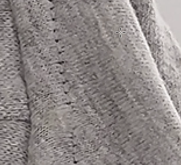

Your phone mistook the fine details in the clothing as noise and "optimized" that:

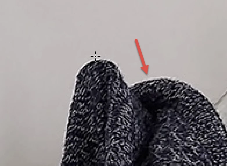

Then, sharpening introduced a halo between the main subject and the background:

If you view the photo at 200%, you can see a white halo between the dark and the light areas. Especially, around the dark jacket and whit wall.
