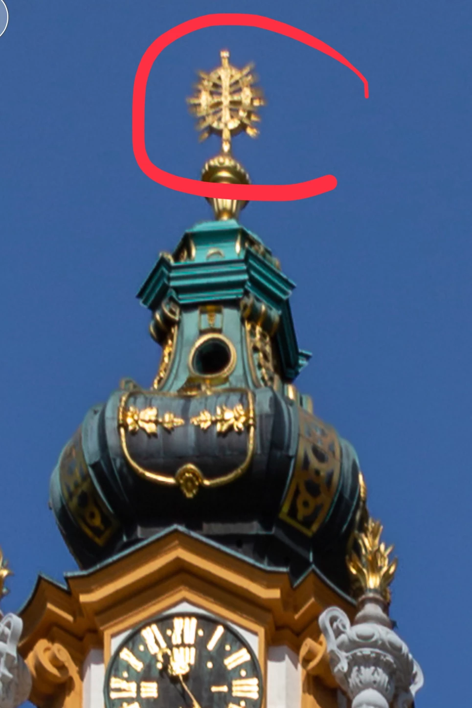

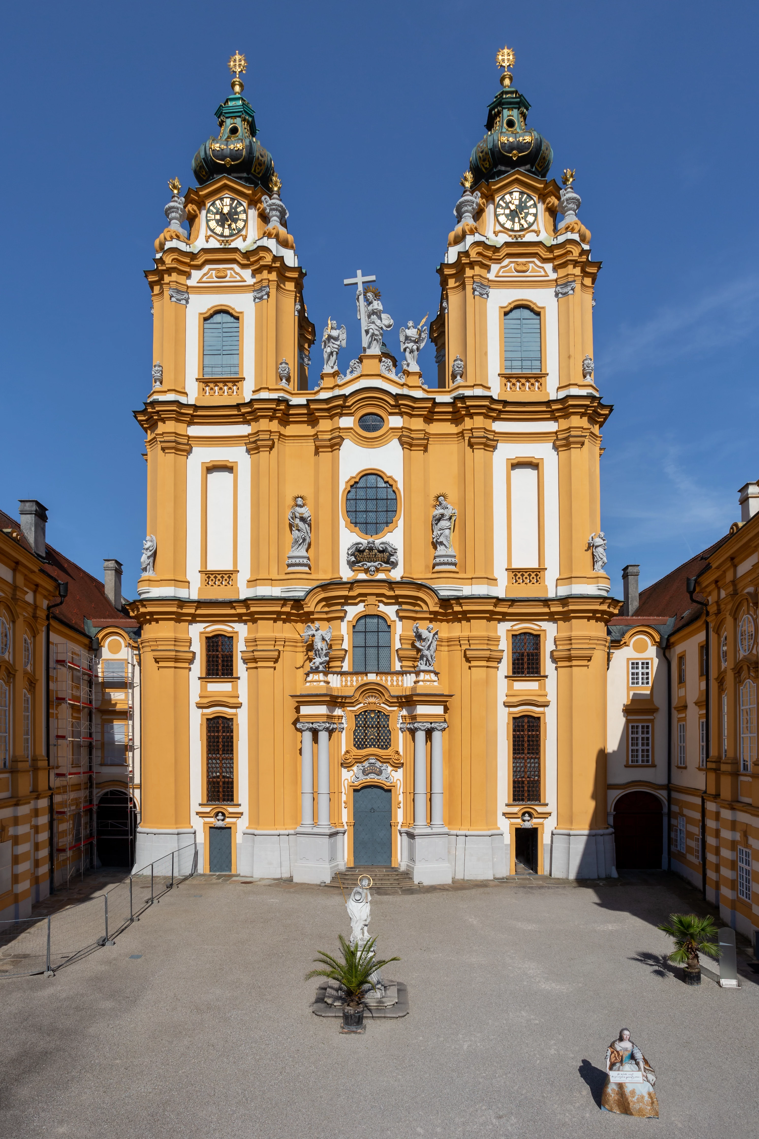

Ok, I'm curious as to what the issues are with this image (and 6 more that are similar travel images).
All rejected due to quality issues. Too sharp? Too soft? Lighting? Too noisy? I'm not sure.
I appreciate any feedback.
Thanks!

Kia ora,
Did you alter the perspective a bit? Sometimes this can stretch the photo a bit too much and increase the lack of sharpness at the edges and introduce artifacts - like in this case, and also when using a wide angle lens and you use the perspective tool to make corrections.
I think you have a slight barrel effect on the church as well. (From the lens.)

February 22, 2023
The lower part looks fine, but the upper part gets you in trouble. You see it immediatly with the clock, but if you look at the picture at 100% you see, that you lose sharpness. And you get artefacts.
February 22, 2023
Thanks - I did check that just a minute ago and see it now. I'll have to check the other images.
Abambo
February 22, 2023
You're welcome. And yes, it may be that the other pictures have similar problems.
