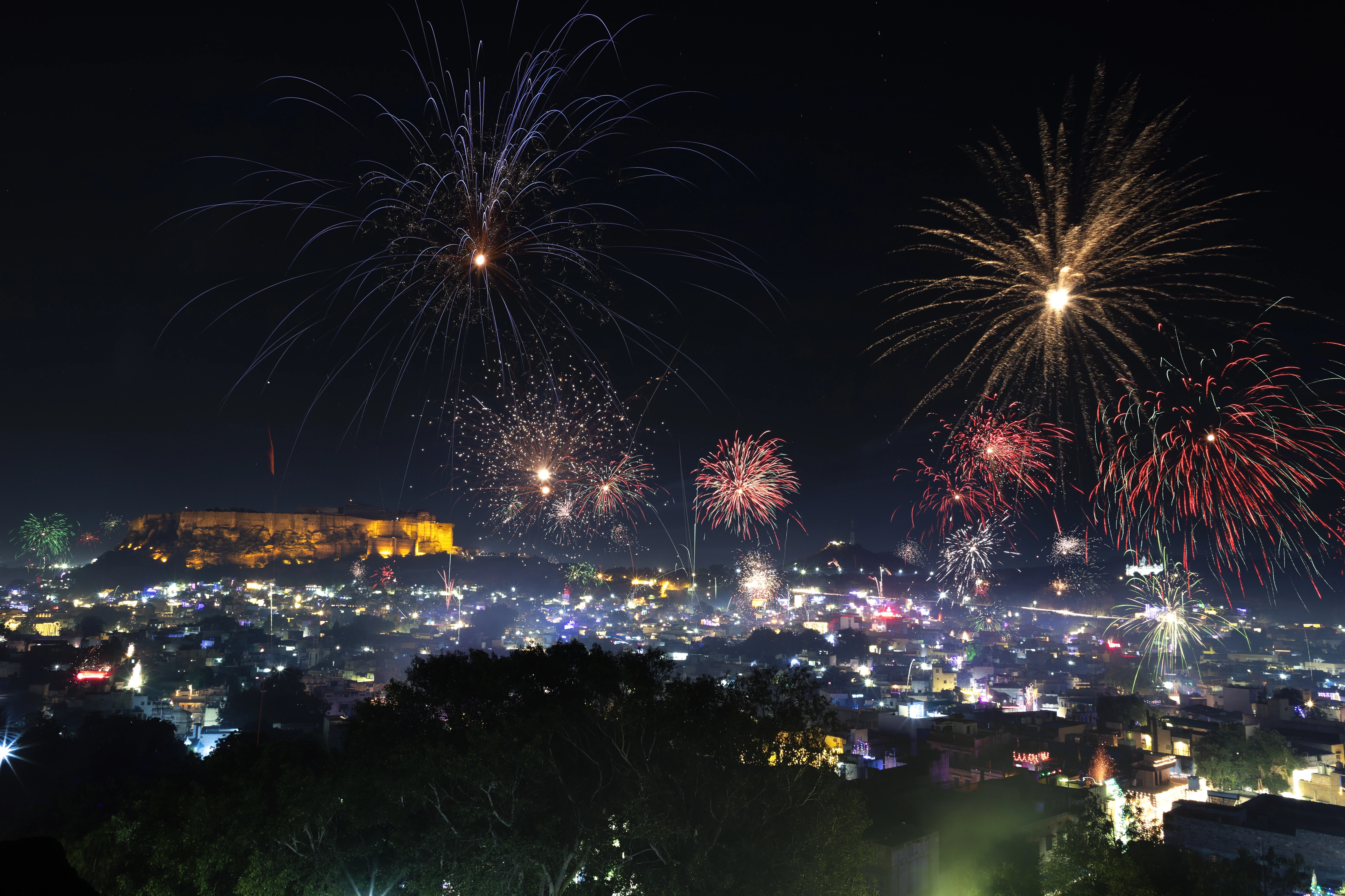

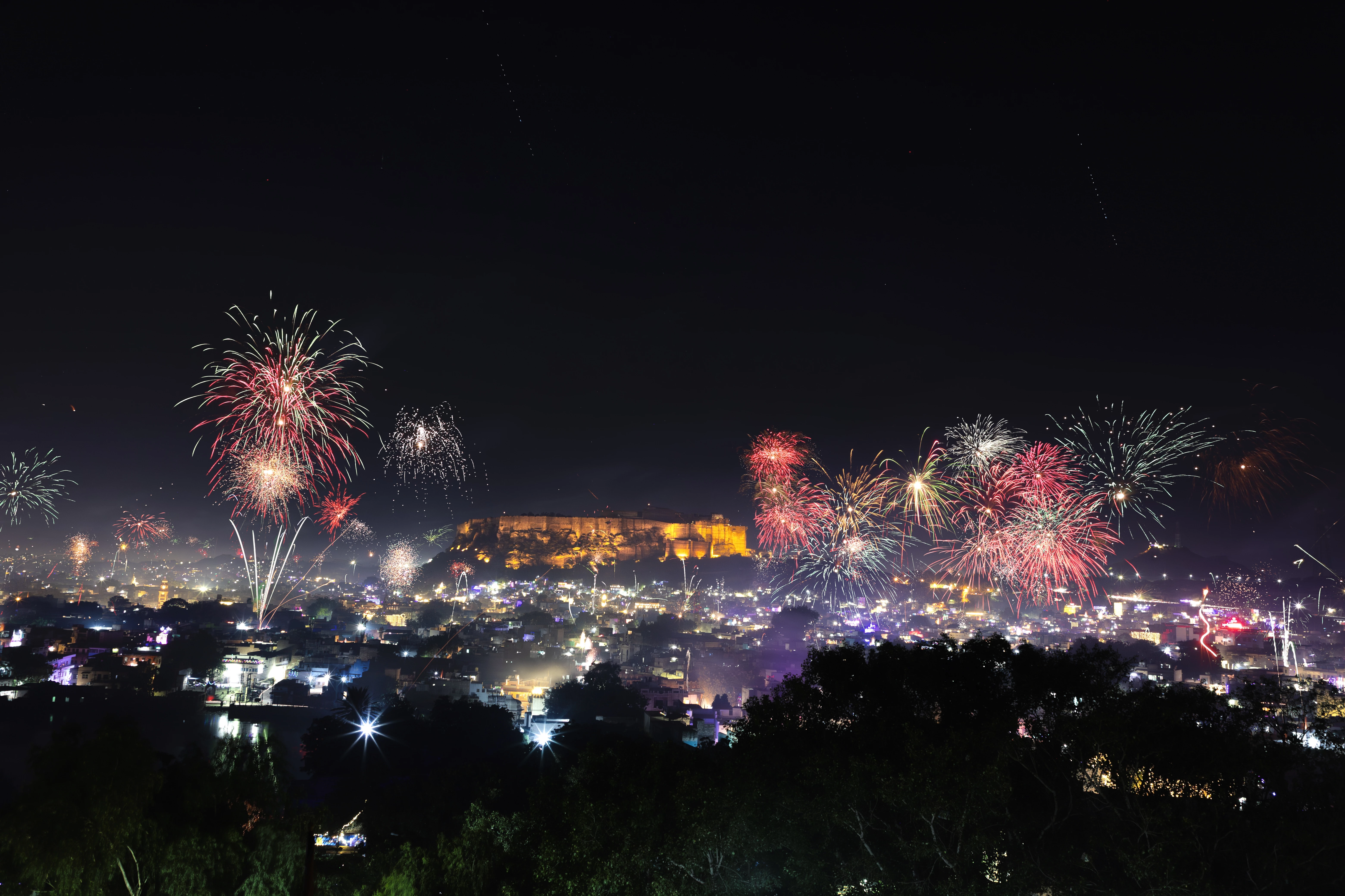

Quality issue
"Common issues that can impact the technical quality of images include exposure issues, soft focus, excessive filtering or artifacts/noise" and I don't see any bid issue, successful aproval on other platforms if anyone can help me for this simple multiple exposer images.

Feb 12, 2025 10:41 PM UTC
Do not put the emphasis on the stock test. That may or may not be the case for your picture. The moderator did refuse your assets probably because of the exposure. Whites are missing, technically your picture is underexposed. Such night pictures are not that easy to expose correctly as you need enough darkness, and no over exposure.
Having assets accepted on other stock plattforms is no guarantee to get them accepted here and vice versa. Adobe still seems to have a high quality standard for photographs, even that they allow a lot of generative AI scrap to pass.
I would say that you should adjust the exposure and try again, even tht from a composition point of view, I do not think that this is a very attractive asset.
If you have shot this in raw, adapting the exposure should be a nobrainer. Personally, I would probably compose two different assets, one as a shoot without fireworks and then just the fireworks, with less of the surroundings visible. But that will be an option for you for the next shoot, as you need to plan in advance.

rural_wildlife
Feb 13, 2025 7:43 AM UTC
If you are right, I will use tow different shot one proper exposed according to histogram and second one with fireworks.
Thanks
Abambo
Feb 13, 2025 10:44 AM UTC
If I'm right, you will get great fireworks pictures.
Jill_C
Feb 12, 2025 7:43 PM UTC
Were these shot on a tripod? It appears that the stationary objects - buildings - in the scene are not in sharp focus.

rural_wildlife
Feb 13, 2025 7:36 AM UTC
Yes on trypod, not enough sarp becouse of smoke
