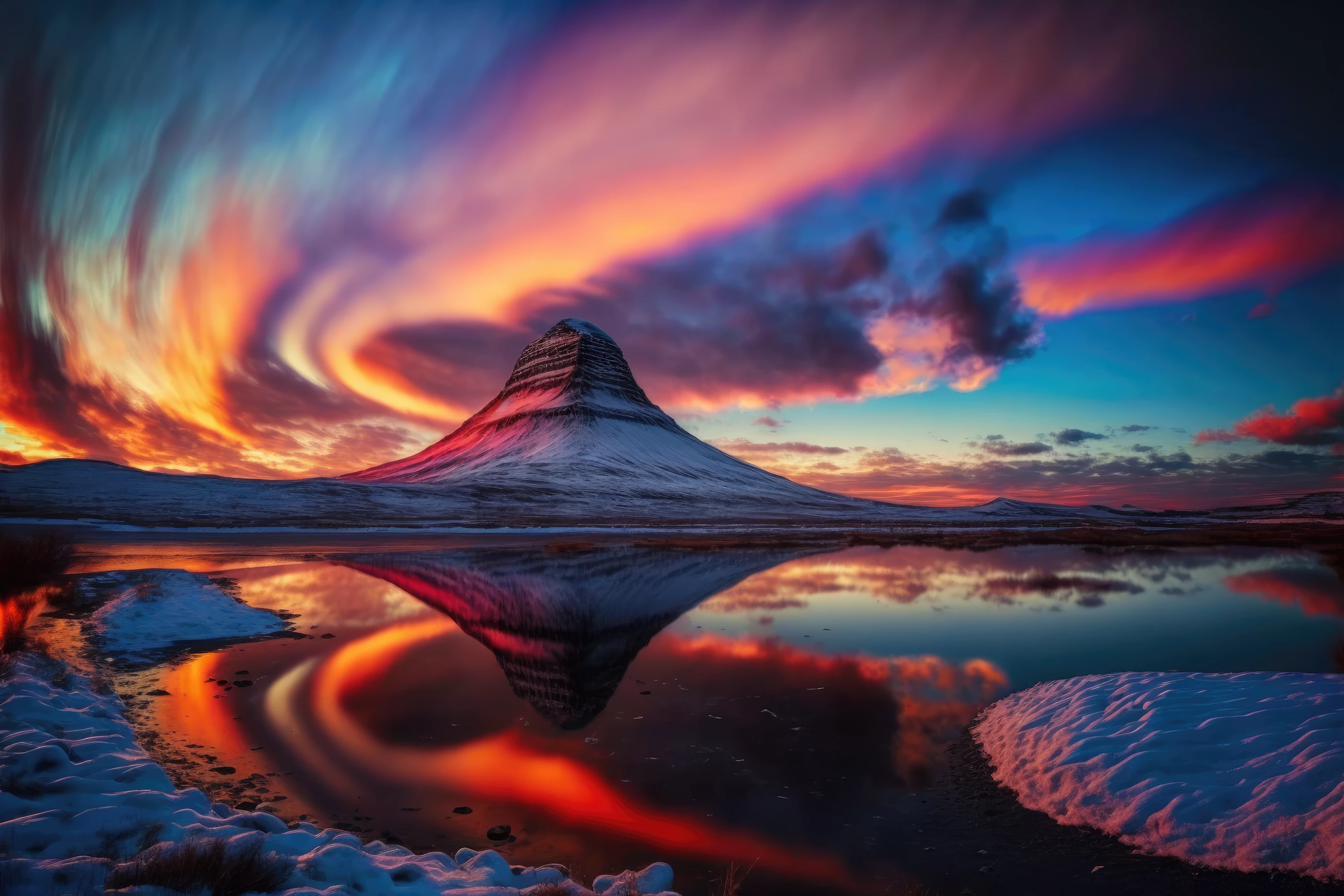

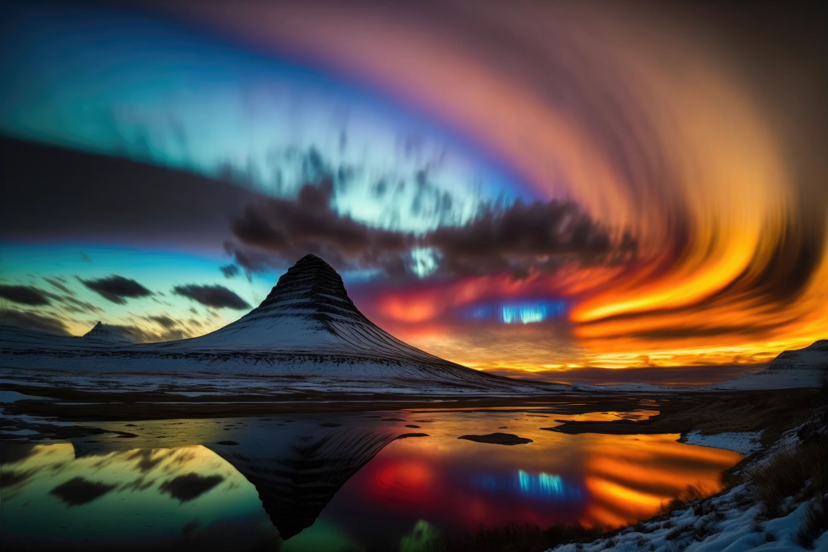

I've got rejected a bunch of images because of "Quality Issues". That's a little vague to me, but I've read all I could about. I'm posting 2 images, no need to show all because the rest are simmilar. Could them be too underexposed? But the subject requires to be a darker image and I've seen tons of accepted that were darker and _really_ underexposed. Oh, and these are generative AI. Not sure it counts, still interested about the quality issue here 🙂

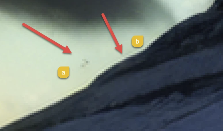

Dark is not underexposed. The histogram is nearly OK. You could add a bit of highlights.
Disturbing are, however, these artefacts (a) and this line of lighter pixels (b):
Or errors like here:

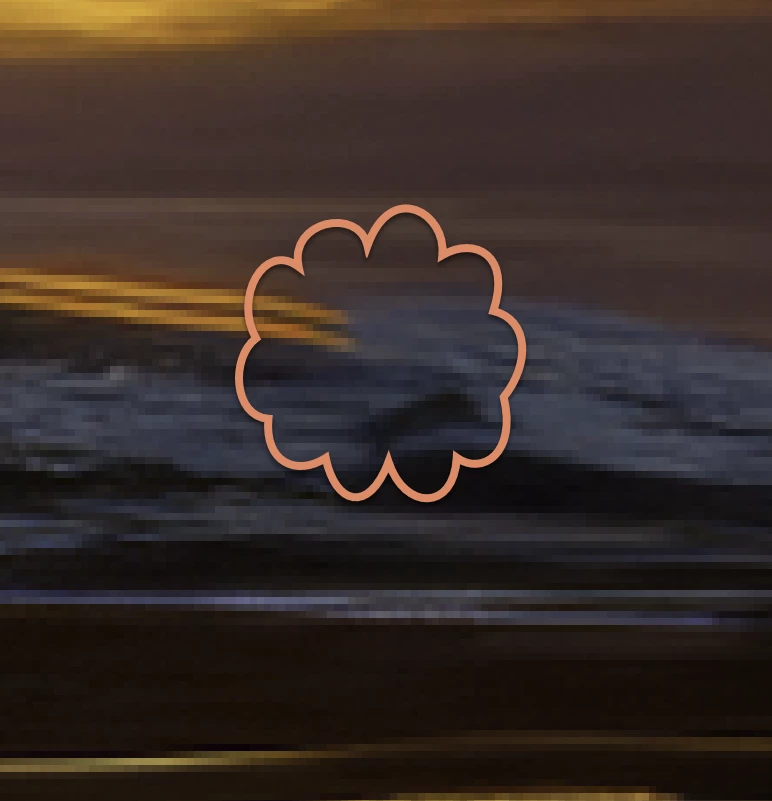

And look at these lines at the lower left side:
There are other errors.

The JPEG compression is lossy, that is correct, but a first generation JPEG saved with high quality, does not distinguish much from the original. It's only after several generations, load, save, load, save ... that you will see artefacts, given that your save quality is high enough.
My only reason to avoid JPEG as a final file would be the 8 bits/channel reduction of a 16 bits colour image, if that is of interest for the customer.

I also don't think the colour or saturation is an issue. Most probably, it's the type of error that @Abambo pointed out. AI tends to introduce such errors which can interfere with the quality check. It's the small things that count.

Now that you've magnified 400% the image, I see those flaws. Didn't spotted them at 100% magnification. Some of them are easy to fix. I'll reexamine my images, make a smaller selection, fix what I can and resubmit. Aaaand, I'll know in about 3 or more weeks if that was the issue, with the waiting times these days 😉
Abambo
March 9, 2023
Well, I needed to get to 400% as on my 4k screen the errors were perceptible but not much visible. It's always that you see that something is wrong. After having seen AI assets for some time now, I started to know where to look at.
