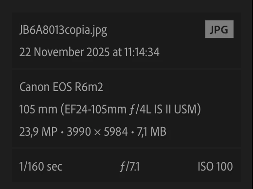

the photo was taken at 1/160 at F7.1, the focus is on the person on the left, if it is not in focus it means that there is a problem with the equipment, because I noticed these problems only by sending the photos to Adobe and with the old camera I never had similar problems.
