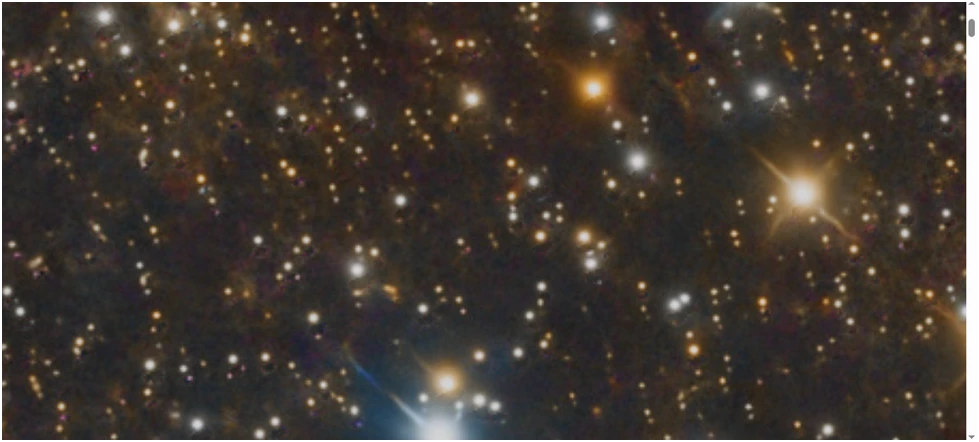

I recently submitted several astrophotography images to Adobe Stock, but all of them were rejected. The files I uploaded include:
These images were created from multiple exposures and processed using astrophotography techniques (composite stacking, noise reduction, calibration, etc.). However, all of the source images were captured by myself, and I hold the full copyright to the final works.
I carefully ensured that the submissions meet the technical requirements (resolution, noise level, sharpness, framing, and composition). However, I did not receive a detailed explanation of why they were rejected.
Could you please provide more specific feedback regarding the rejection reasons? For example, was it due to:
  • Technical issues (focus, noise, exposure, artifacts, etc.)
  • Metadata or keywording problems
  • Content suitability for stock use
I would like to understand the reasons so I can improve my submissions and ensure that future uploads meet Adobe Stock’s standards.
Thank you very much for your time and support.

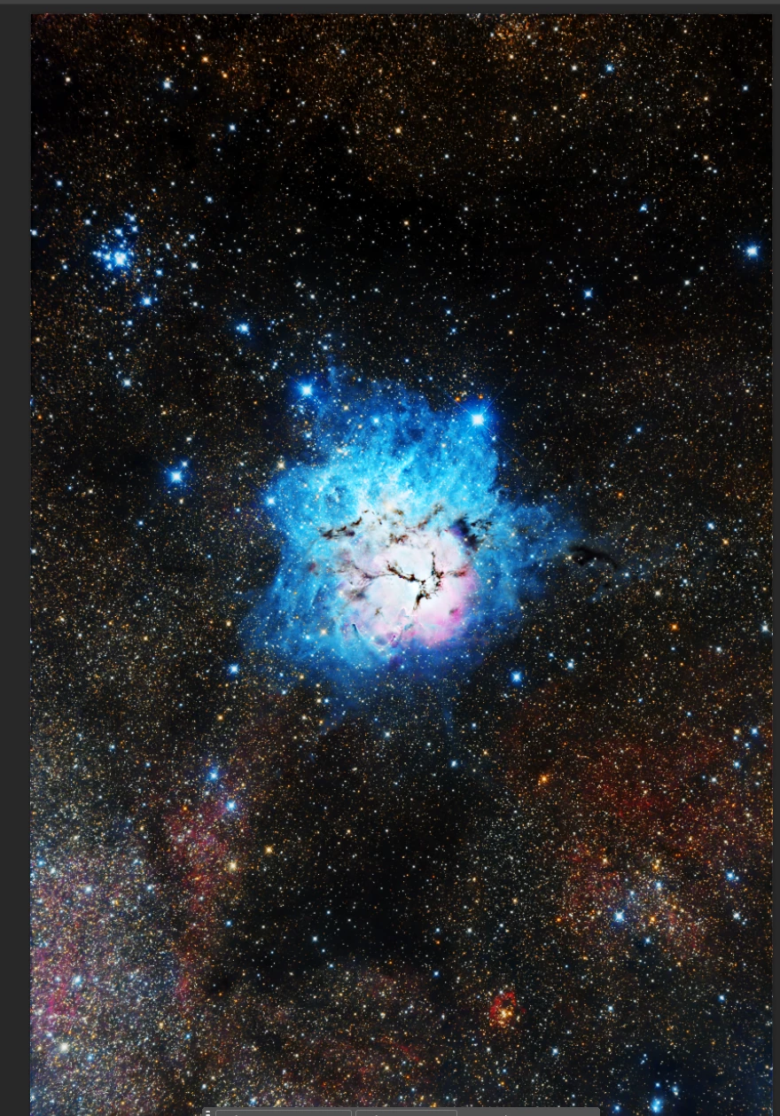

Aug 19, 2025 2:58 PM UTC
The photos look milky, no pun intended, you need a lot more blacks. If you're not using the latest Lighroom or Photoshop, you're missing out big time. All I did was add black and a tiny bit of contrast and the change makes your shots as good as any amateur selling their work here. You are going to hear different opinions here about using AI to denoise your shots (I do it to a lot of my work successfully) The shots I am sending you I used Topaz and increased the blacks and only added a little bit of contrast.  I also suggest using Grok to ask regarding Adobe's guidelines for submitting interstellar photos. Idk if Adobe already ahs too much of this and doesn't want any more, the fact is that your shots are awesome, and with a little bit more of post work you will be proud to call them your own.
Best of luck
ZALEZPHOTO

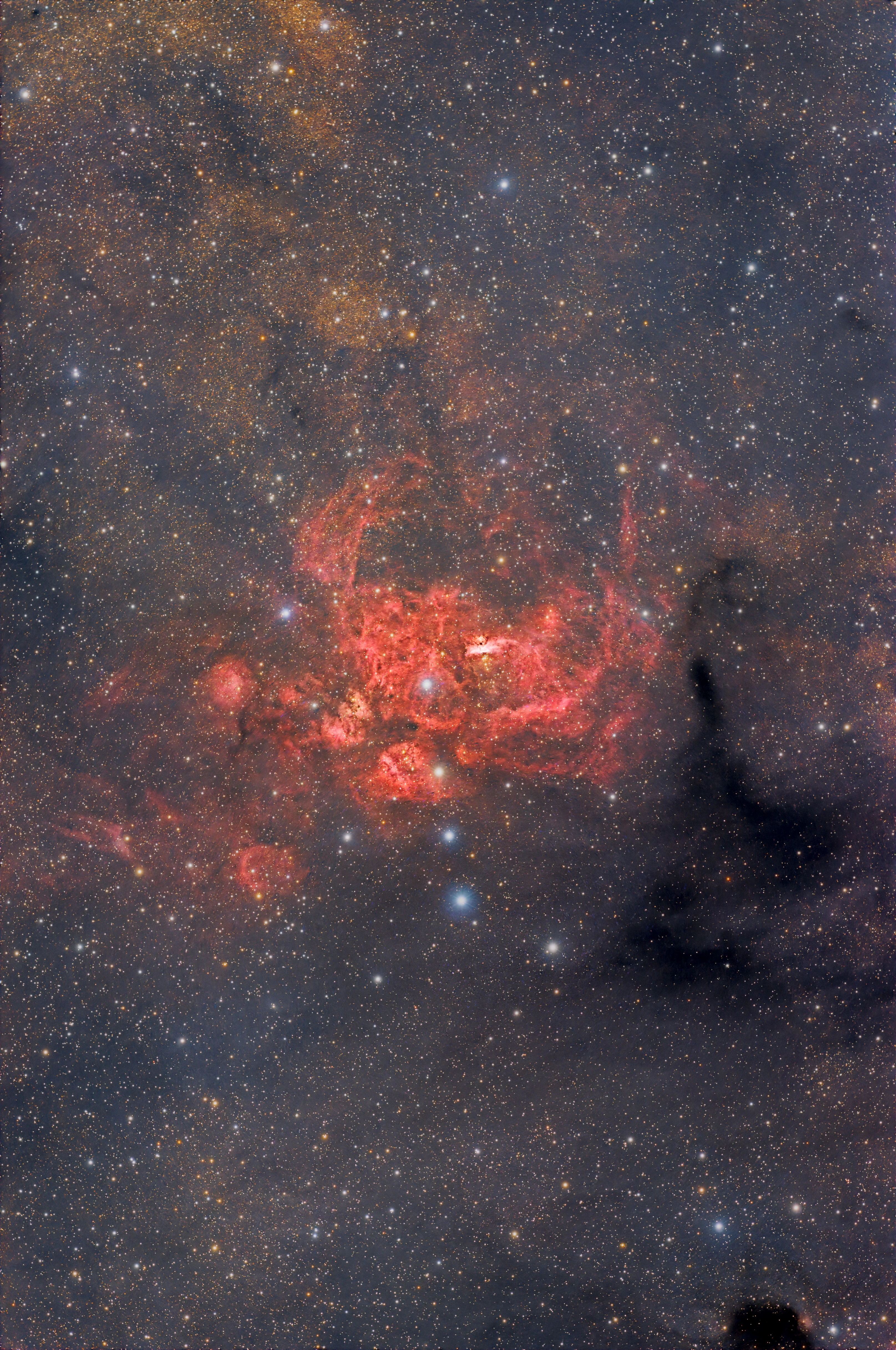

Aug 22, 2025 1:13 PM UTC
I wanted to sincerely thank you for the valuable feedback you gave me on my astrophotography submissions. Based on your advice regarding adding more blacks, adjusting contrast, and handling noise reduction carefully, I reprocessed my images and resubmitted them.
I am happy to share that this time, my photos were successfully accepted by Adobe Stock. Your detailed suggestions about post-processing, and your encouragement, really helped me improve the presentation of my work.
I truly appreciate your time and generosity in sharing your knowledge. Thank you again for guiding me in the right direction.

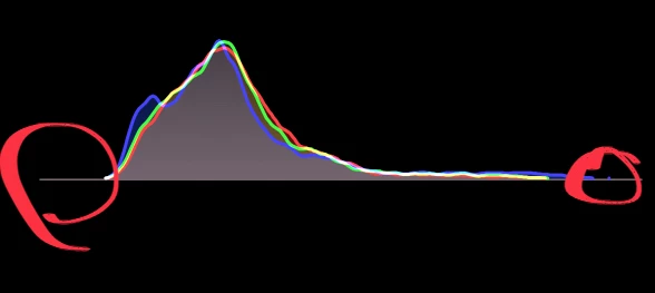

Aug 19, 2025 12:19 AM UTC
You should tell us the rejection reason. Was it quality? Even on those small preview pictures I can see that there are exposure issues. You can check it, by looking at the histogram:
In addition there is chroma noise.
Aug 19, 2025 11:52 AM UTC
Thank you for your question. Regarding the rejection reason, Adobe Stock indicated that there were technical quality issues, such as exposure problems and noise. Taking advice from others into account, I plan to review and improve background noise, chroma noise, and tonal representation to create higher-quality images in the future.

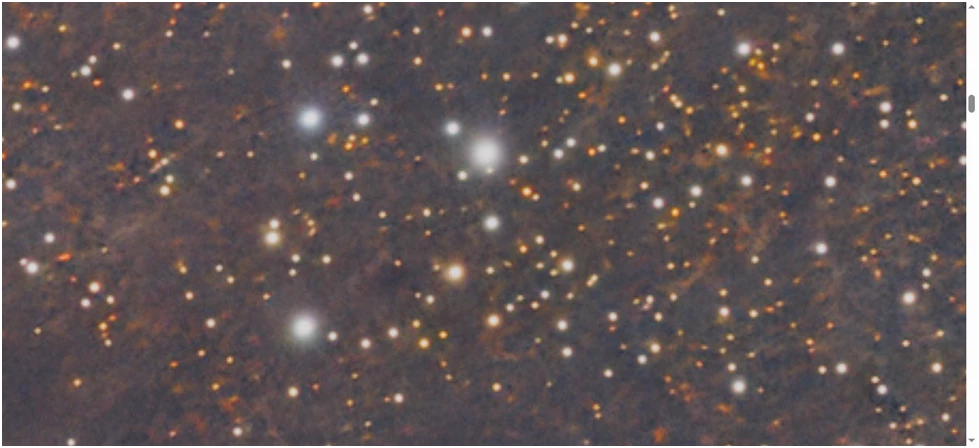

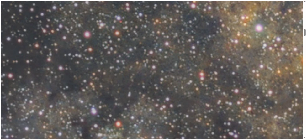

jacquelingphoto2017
Aug 18, 2025 11:32 PM UTC
Hi @Yukihiro Iyama ,
They all seem to have chromatic noise.
Best wishes
Jacquelin
Aug 19, 2025 11:48 AM UTC
Thank you for pointing this out. I understand now that my images also show chromatic noise, especially in the darker regions. Since astrophotography often requires heavy stretching, it’s easy to introduce color noise, but I see that this is not acceptable for Stock submissions.
I will reprocess my files with stronger chrominance noise reduction (using tools like Lightroom color noise reduction, etc.) and ensure that the background looks clean and smooth while keeping the nebula details intact. Hopefully this will bring the images closer to commercial quality standards.
Thanks again for your valuable feedback.

RALPH_L
Aug 18, 2025 2:20 PM UTC
I looked at the histogram to the second photo, it has some loss of details due to pure black. Check your histograms that all tones are present and that there are no white or black details lost.
Aug 19, 2025 11:46 AM UTC
Thank you for your reply. As you pointed out, in the second photo, some details are lost in the pure black areas due to the dark nebula. In astrophotography, black regions are naturally present in dark nebulae and deep space, so I am considering how to preserve details without creating pure black clipping. I will study other Adobe Stock works to learn how to handle this better.
Ricky336
Aug 18, 2025 12:31 PM UTC
I think you have to adjust your contrast, levels, tone curve, etc, to give the photo more depth. It is somewhat flat and dull currently. Not enough blacks. Just a thought.
E.g.:
Aug 19, 2025 11:40 AM UTC
Thank you for the feedback. I understand now that the rejection may be related to clipped blacks in the histogram. Since these are astrophotography images, I tried to keep the background dark to emphasize the nebula and stars, but I see that having pure black values can cause loss of details for stock requirements.
I will reprocess the images to slightly lift the shadows and avoid pure black or pure white clipping. Hopefully this will make them more suitable for Adobe Stock submission.
Thank you again for your helpful advice.
