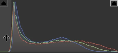

SAM is missing blacks according to the histogram:
All the other pictures are underexposed.

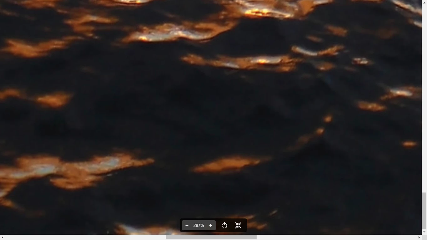

IMG_8570_sunsetfromsunnyside_pk.jpg - no detail in the shadows
IMG_4171-4172_pano_pk.jpg - no detail in the shadows and noisy sky

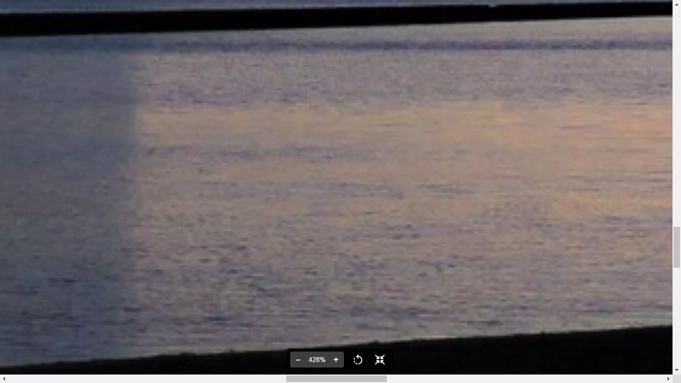

crookedslide_IMG_6706_pk.jpg - zoom in between 100-200% and you'll see that there is a lack of detail and soft focus in the tree line
SAM_1757_water_pk.jpg - soft focus throughout

The first file is underexposed and with chromatic noise.
The second file is also underexposed and details are lost.
The third photo is underexposed.
The fourth photo is underexposed and with chromatic noise.
