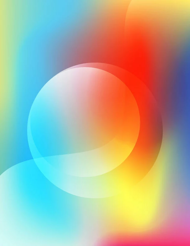

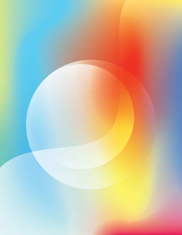

    For example, I ran a direct conversion test on a vibrant abstract background design (RGB vs. CMYK):
    RGB Version
    CMYK Version
    • In RGB: The electric cyans, fiery reds, and intense yellows radiate bright light, and the translucent spherical overlay maintains a crisp, glowing contrast against the background.
    • When converted to CMYK: The colors naturally dull down to fit printable ink gamuts (which is expected), but the complex transparency math and gradient mesh curves shift so much that the soft ambient light overlay loses its depth and flattens out completely.
    The Non-Designer Buyer Factor: If a trained graphic designer downloads the file, they will understand color spaces, gamut limits, and how to manually rebuild mesh nodes or transparency stops to fix the contrast. But what happens when a regular person (a small business owner or marketer) buys the template? They expect to just edit the text and send the EPS/PDF straight to a print shop. When their printed poster comes back looking washed out or flat compared to the bright screen preview on Adobe Stock, it leads to confusion and disappointment.
    I’d love to get the perspective of experienced contributors on how you navigate this balance between high-vibrancy screen thumbnails and practical print usability!
