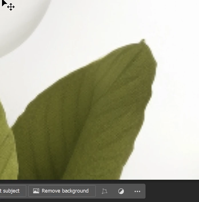

Upper corner, left:
It's unsharp and you see at 100% artefacts.
A bit more to the right:
This is a severe aliasing problem. Seeing this at 100% in this detail lets me think that you have a severe upscaling issue. You see aliasing everywhere, I won't take a screenshot of all cases.

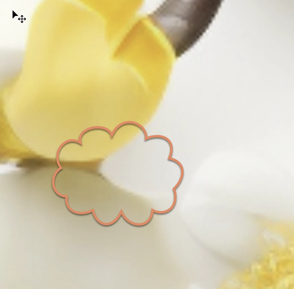

Middle left (200%):
This looks like a bad cutout work.
