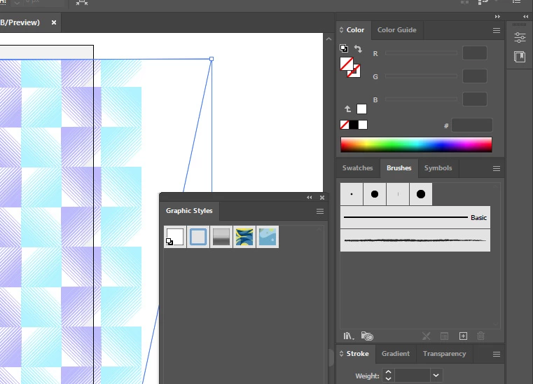

Your artwork contains unnecessary and redundant brushes, graphic styles, and – possibly most importantly – objects ‘under the mask’ that extend out of the edge the artboard.

Hello, thank you for the answer. But, are you sure that is possibly the reason why my file is being rejected? Because it is not written in the rejection reason above.
And also, after i checking on my previous file, I have several approved files before that have brushes, graphic objects, and the object under the mask that exceeded the edge of the artboard already in the adobe market. Is this a new requirement?

And yeah, there’s also an error in your file with “Artboard offset: (0,0) upper-left corner.” I won’t attach a screenshot, but check it — your coordinates are off.
