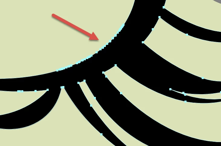

You need to simplify your curves. You have massively points.

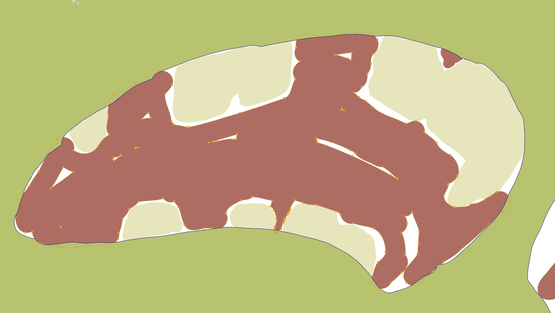

In addition, you have this:
Which is also hell more complex than needed.

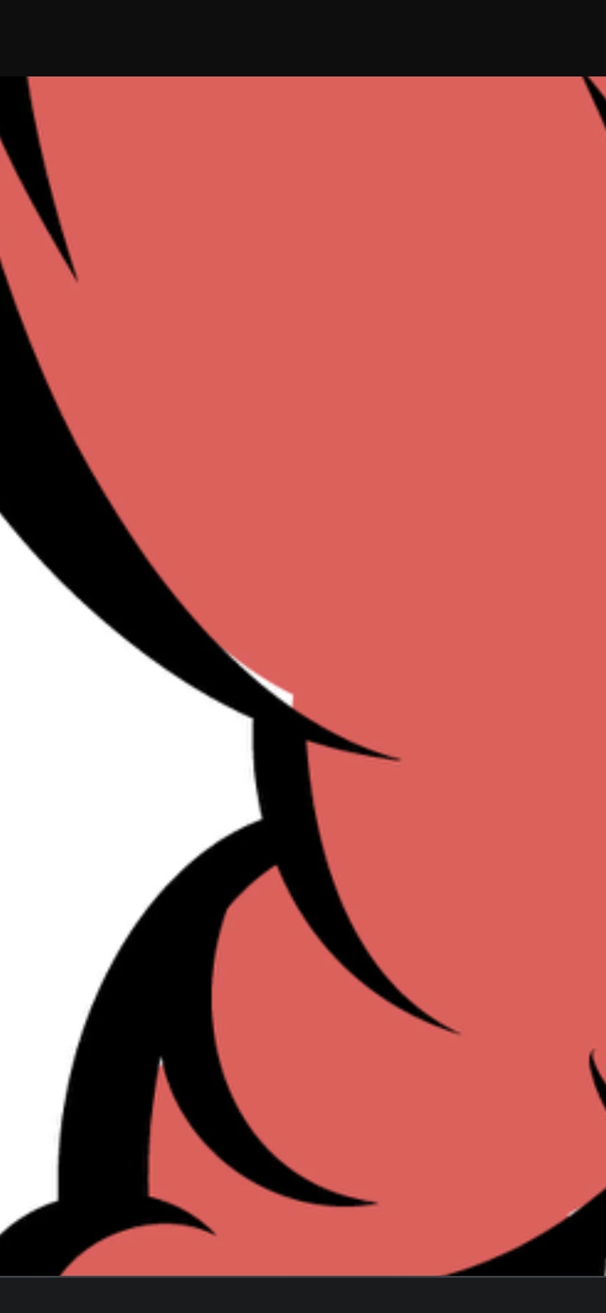

George_F
October 2, 2023
Although maybe not the only reason, there are a few spots left unfilled throughout the image.
The lines around the nails could be interpreted as unfinished, even though it appears you did this intentionally.
