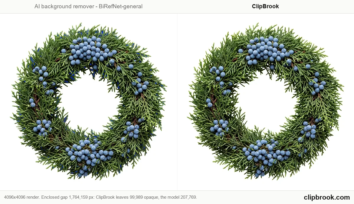

Take a wreath. There's a hole in the middle, and the background inside that hole has to go. What I kept getting was a grey-blue haze sitting in there. Looked fine as a thumbnail. Looked awful the second you put it on a colored card. Pine needles came out as mush. Thin stems either disappeared or came back with a blue edge burned into them that no amount of levels would take off.
Then I actually read what rembg does. It shrinks your image to 1024x1024, asks the model where the subject is, gets a 1024x1024 mask back, and stretches that mask over your full size image. u2net is worse. That one works at 320x320.
My renders are 4096. A needle two pixels wide doesn't exist at 320. So it's not that the model is bad at needles. The needle was gone before the model ever saw it.

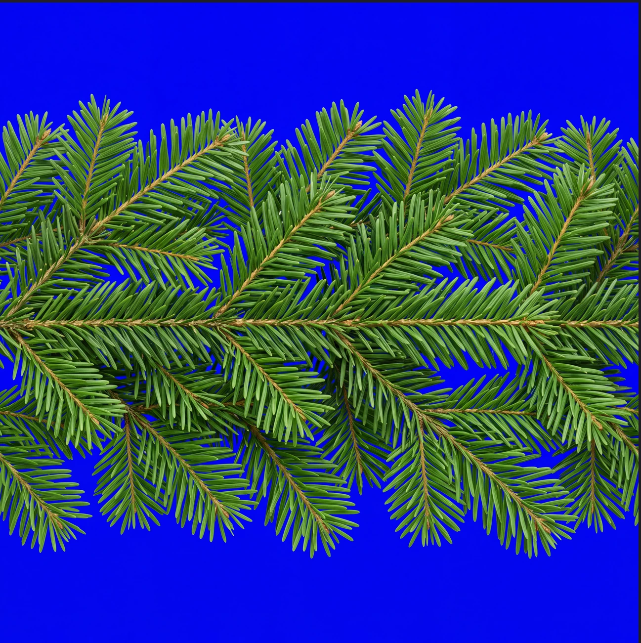

Once I understood that I stopped asking a model to guess. Now I render on a flat color the subject doesn't contain, and take that color out with arithmetic.
Two parts to it. The prompt matters more than the cutting.
The prompt:
You can't key a background that isn't keyable. Four things have to be true and generators will break all of them unless you say so: the background is one flat color edge to edge, it stays that bright inside every gap between leaves, the edges are hard with no blur or glow, and no colored light bounces onto the subject.
Pick the color by what your subject isn't. Blue for almost everything. Red if the subject itself is blue or purple. Never green. Everything I draw has leaves, and green takes the leaves with it.

Now the background is one known color, so there's nothing to guess at. It measures the actual color the generator produced, which is never the one you asked for. Ask for pure blue and you get something with green in it, usually somewhere between 25 and 70. Then every pixel gets sorted into subject, background, or the bit in between, and the in-between ones get a real fraction of transparency instead of a yes or no.
The part I'm most pleased with is the holes. Any background-colored area that never touches the edge of the image is the inside of a wreath, so it gets cleared too. A matting model can't do that. It has no way of knowing what's inside a hole it can't see around.

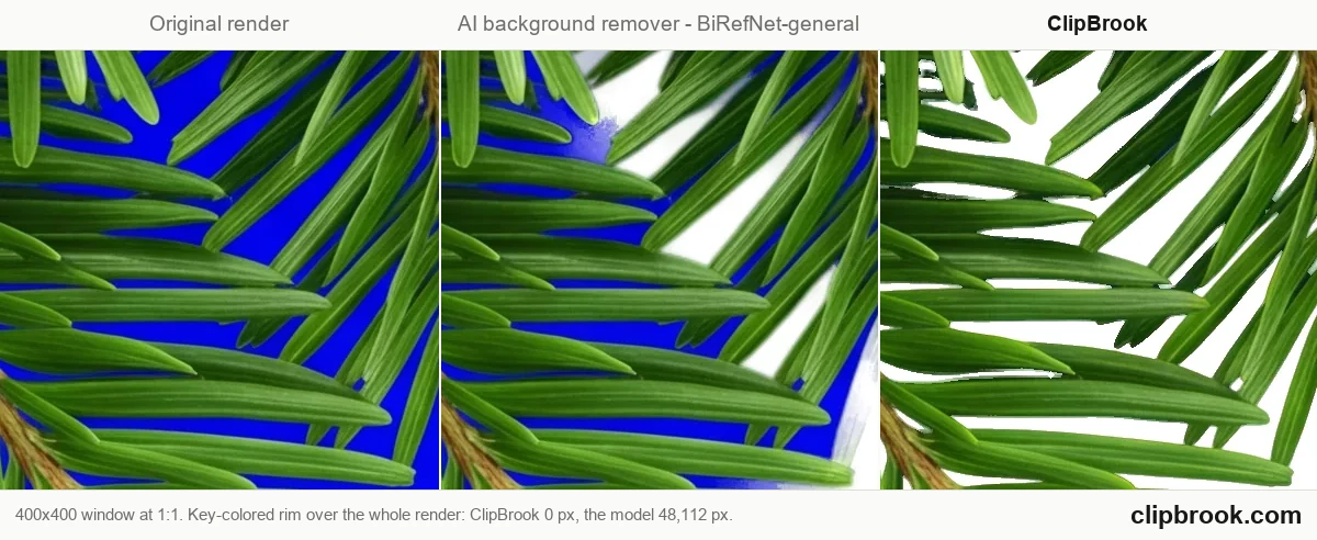

Last step takes the blue back off the edges. Edge pixels pick up color from the background around them, so it samples the subject's own color from further in and subtracts the tint. Took me weeks to work out why fir needles kept their blue rim after that step. The needle is thinner than the distance it was sampling from, so there was no inside left to sample.

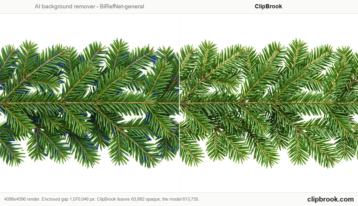

Some numbers on one 4K pine border, against BiRefNet with alpha matting turned on, which is its best setting:
- background left inside the holes: 63,892 pixels mine, 613,735 theirs, out of 1,070,046
- blue left on the edges: 0 mine, 48,112 theirs
- how wide the soft edge is: 1.8 pixels mine, 23 theirs
BiRefNet is faster and I'm not going to pretend otherwise. 2.3 seconds against my 17 on the same machine. With alpha matting on it's 47. If you want a quick rough mask, use the model.
