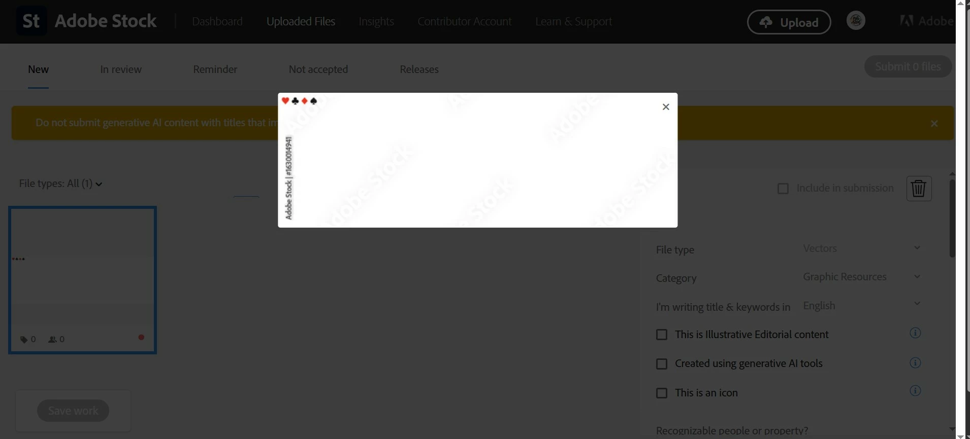

Why are my EPS icons showing tiny in the corner after uploading, when using multiple artboards?
I,m creating icons in Adobe Illustrator using 20+ artboards in the same document.
When I save each artboard as an EPS using Use Artboards, the file previews normally inside Illustrator.
However, after uploading to Adobe Stock, the preview shows my icon very small in the top-left corner with a lot of empty space.
I suspect it’s related to the way multiple artboards are positioned on the canvas (pasteboard) in the document, but I’m not sure how to fix it so Adobe Stock previews them correctly centered and full-size.
What I’ve tried:
  • Aligning artwork to the artboard center
  • Fitting artboard to artwork bounds
  • Removing stray points and hidden objects
  • Rearranging artboards with smaller spacing
Question:
How can I prepare my Illustrator file (with multiple artboards) so that each exported EPS uploads to Adobe Stock with the icon centered and filling the preview, instead of appearing tiny in a corner?

I do not upload EPS files and I do not upload files using multiple artboards, but you have to know that artbords is a "recent" addition to Illustrator.
Check what happens when you import the file back into Adobe Illustrator, or may be better Inkspace.
Try a clipping mask to the artboard. If that does not help:
My suggested solution would be, to duplicate the file once for each artboard and to delete in each file all data and artboards that are outside of the correct artboard.
