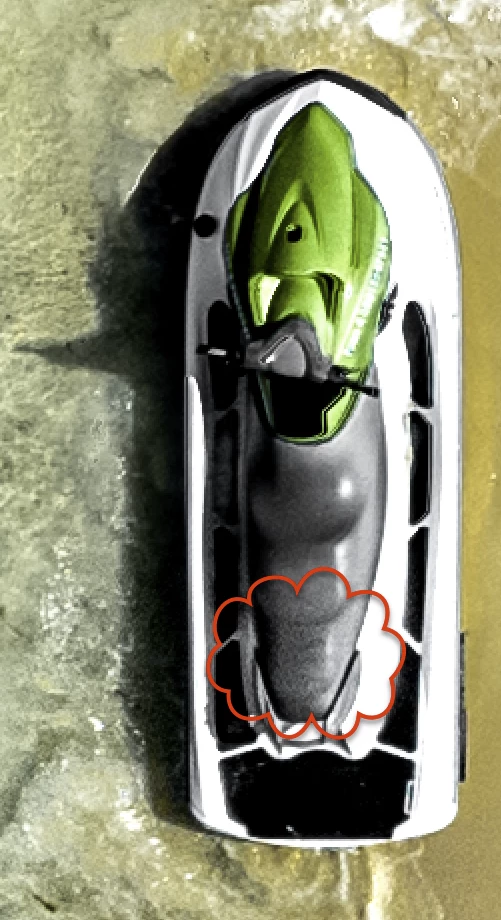

Umbrella: exposes artefacts typical of over sharpening for small sensor cameras.
The shadows are strange, as if the picture is missing contrast, the saturation is strong.

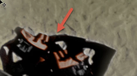

There is a halo with the beach flag:
The picture is overall a bit noisy, despite this strange flat shadow gray. Those are quality issues.
In addition, I would say that the beach flag could be an IP violation, but I'm not sure about that. You can, however, recognize the Yamaha logo on one of the boats. That surely is an IP violation.

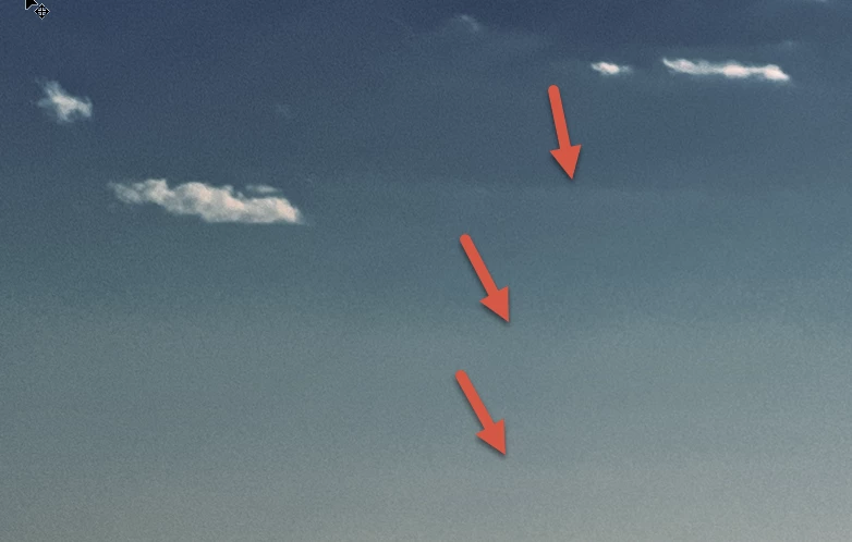

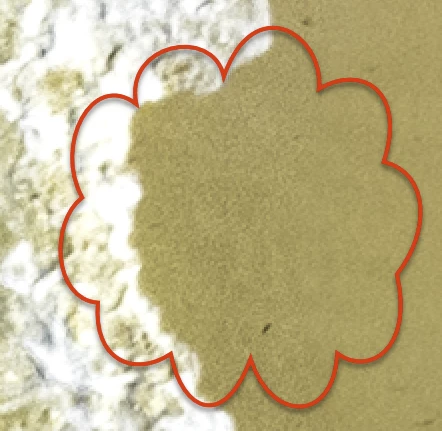

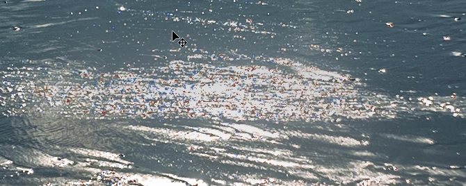

Sunset:
Artefacts on the water:
and the rock-water border:
In addition, you have clipping of the whites, and then you brought them down, getting them a flat grey. When the highlights got clipped, you can't bring back details.
The sky is dithered, like on old GIF images.
There are also those typical GIF clipping lines, and the clouds give the same effect. That happened when you took a full colour (oversaturated) photograph and reduced the colours to 256 and less. (GIF only displays 256 colours max)

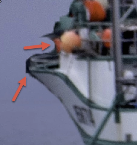

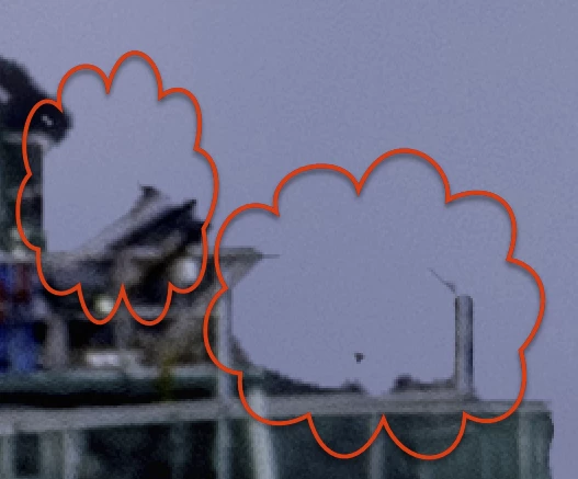

Iceberg:
When composing images, you should do it correctly:
The image is noisy. But it looks partially as if you used a Gaussian soft filter to clear out details.
If you edit your pictures, do so, that it is not obvious.
The boat, with some phantasy, can be identified, and it would be identifiable without any doubt if the photograph was of the required quality.
