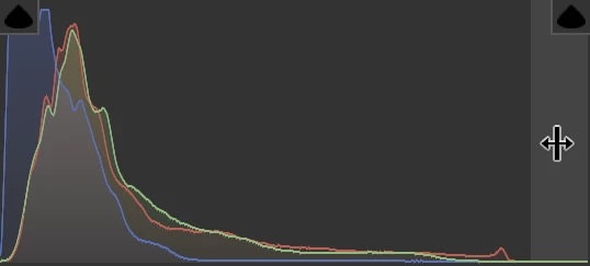

Noisy and underexposed, as the histogram shows:
There are no whites and most of the action is in the blacks.

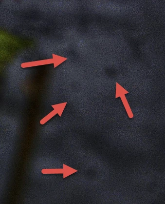

This here looks like sensor dust:

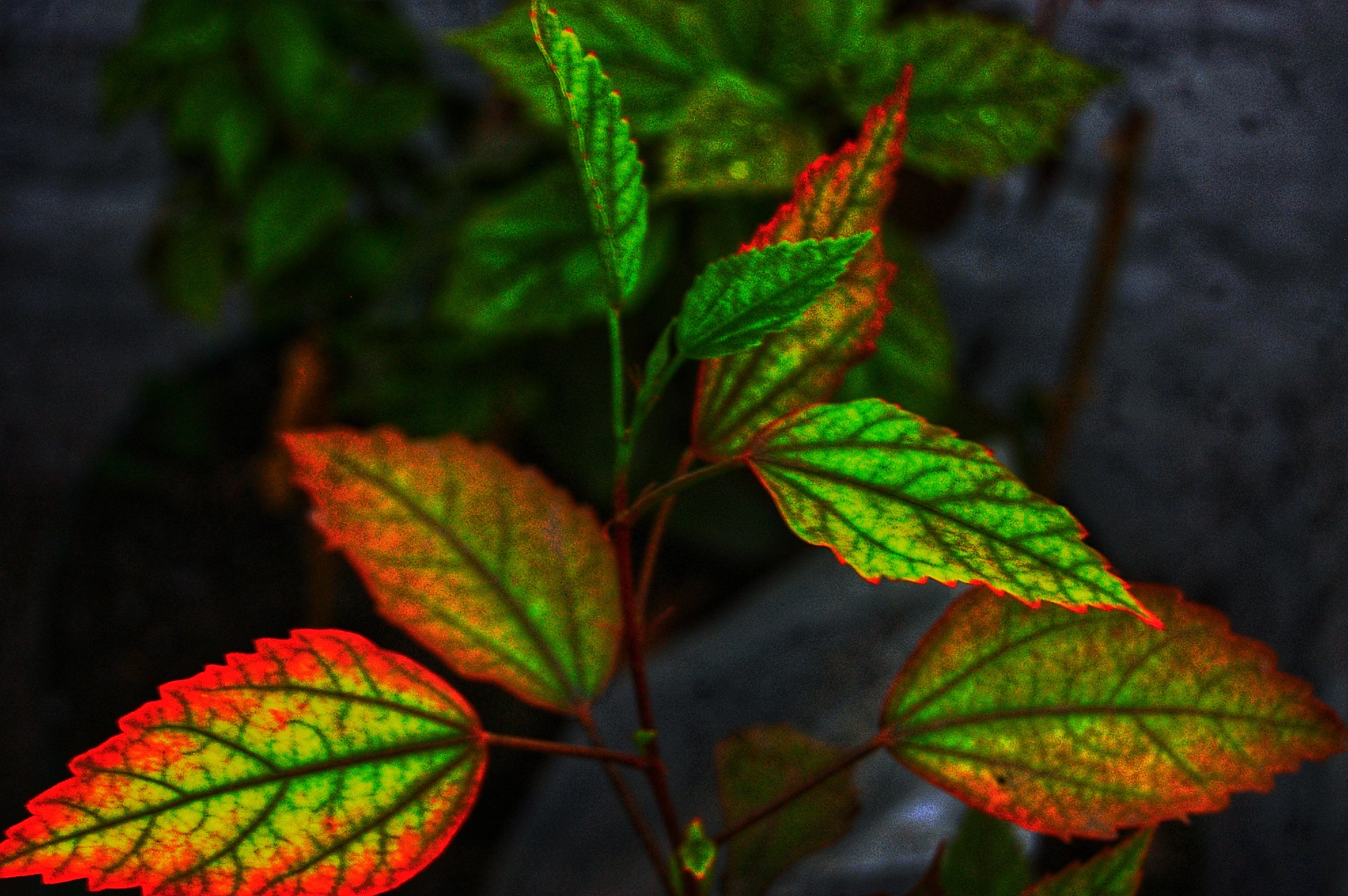

I would assume that you processed this image as an HDR.

HI Contributors the above image a sample of one that i clicked and i dont understant that why this is been rejected and also i want to tell you guys about my camera Nikon D 40 should i do clicks with this camera or should i change this

You can obtain decent images from your older D40 if care is taken with the 3 main aspects of exposure: shutter speed, ISO and aperture. If you "do clicks" with this camera, i.e. treating it as a point and shoot camera, you will NOT consistently achieve the quality that is demanded from Adobe Stock. If you do not understand the basics of the exposure triangle, don't bother investing in a better camera - it won't help much.
Your image is blurry, indicating either subject option or camera motion, and the shutter speed was too slow. The image is very noisy, indicating a high ISO. And the light was inadequate, which could have been addressed by a wider aperture.
The framing is not good - you cut off the edges of the leaves. And the processing is overdone.
Get out the user manual for your D40 and practice, practice, practice before you decide to invest in a newer camera.
