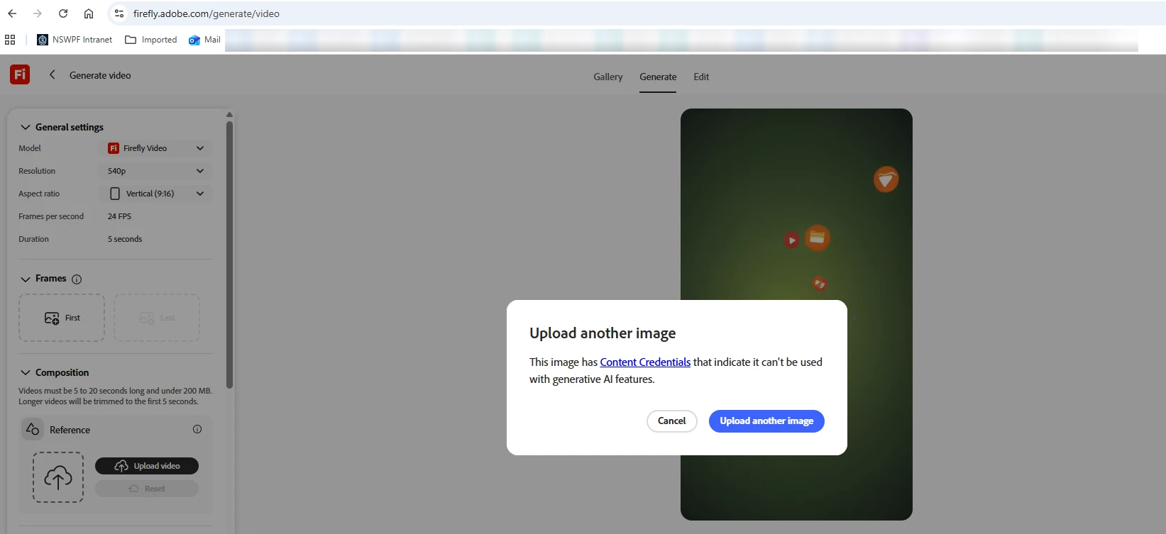

    Jul 16, 2026 4:14 AM UTC
    hi Tarun,
    Thank you for your response. The issue occurs with all images and I’ve tried the copying and exporting images as well. I’ve seen the other post about whitelisting API so I’m forwarding that to my IT department to review.
    Attached is not a video but the msg I get when trying to upload an image.
