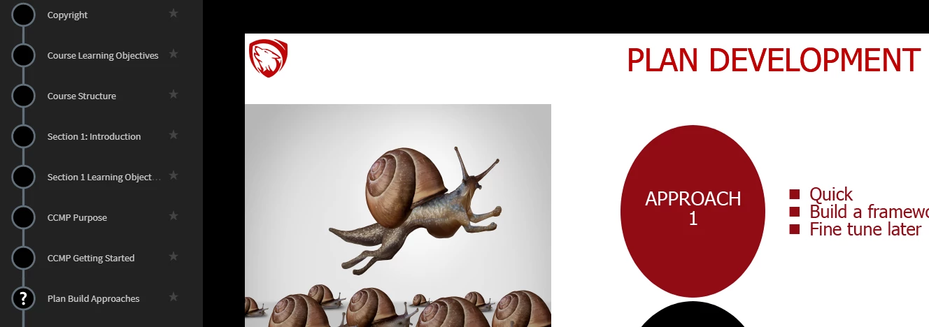

Captivate vs. Prime Next Slide/Next Module and Mysterious ? Marks
Hi. I have two issues I'm hoping to get help with.  I'm not sure if these are bugs or configuration issues.
1) When I preview my learning course in Captivate in the HTML 5 viewer the navigation buttons under the player take me to the next/previous slide (expected behavior), however, when I publish to Captivate Prime the navigation buttons take me to the next/previous MODULE (not expected behavior).
2) Also, same sceanrio (preview vs. publish) in preview the table of contents are on the left and everything looks fine, however, after publishing to Prime there are several (non-quiz and non-knowledge check) slides that have "?" next to them.  I assumed this was an indicator to the learner that there was a quiz or knowledge check on the slide but the slides I have are NOT that nor were they created as that and then reutilized as non-quiz.

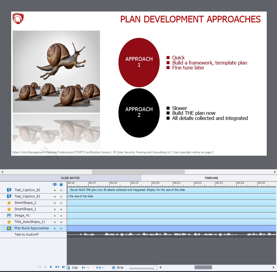

Feb 18, 2020 12:18 AM UTC
Hi.
Thanks.
Re: 2 - I'm not exactly sure how to identify the particular objects you refer to.  Attached is a screen shot that shows the items on one of the slides that has the ? mark in it.  I moved the items around on the page and didn't see anything 'hidden' or 'behind' that would seem to be the culprit.
As seen in Prime...
