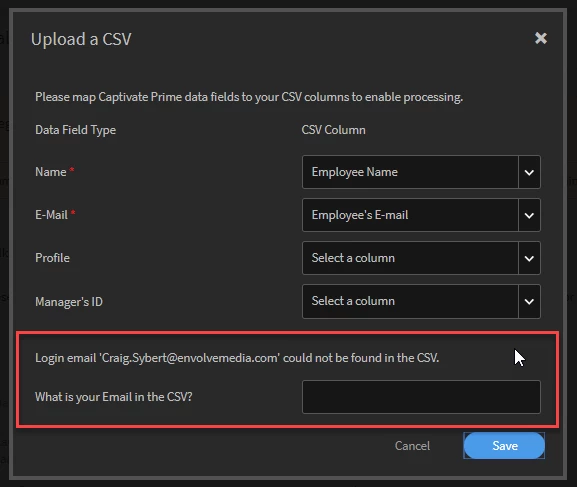

I am having an issue in the same area, but I am getting the error "Login email 'myemailhere@gmail.com' could not be found in the CSV. I have tried many combinations, but I keep coming up with the same error. I would like to attach the two of the files I was using to try and get it to work. Maybe after you post? I am adding a picture of the error. Any help would be appreciated

Apr 17, 2019 10:36 PM UTC
Same issue here. Did you find a way to make it work?
