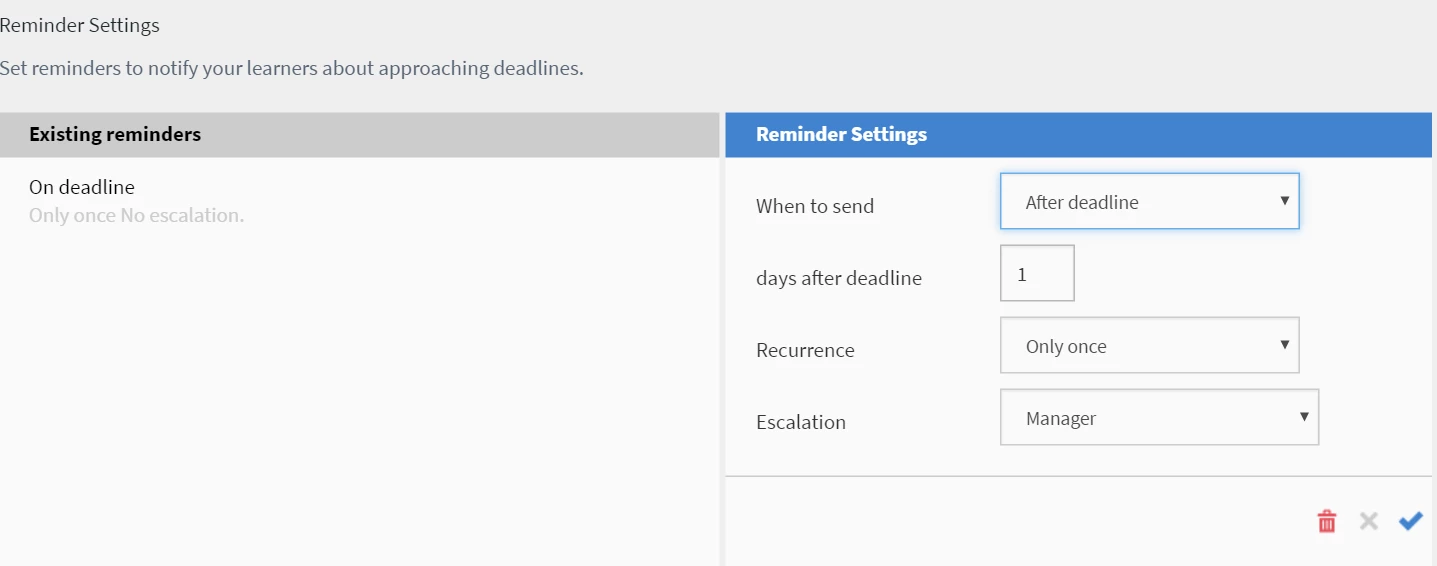

    Hi Peter,
    Once you will add a new reminder. On the left, you will be able to see the "Reminder Settings".
    In the drop down menu for When to send choose "After Deadline".
    Then it will provide you with the Option for escalation and there you can specify the required person.
    I have attached an screenshot for your reference.
    Thanks

    Hi Peter,
    Thanks

    Interesting... wonder why I don't see the Escalation drop down in my reminder setting dialog...wait... this is only available for notifications AFTER the deadline....
    Thanks for sharing the information!
