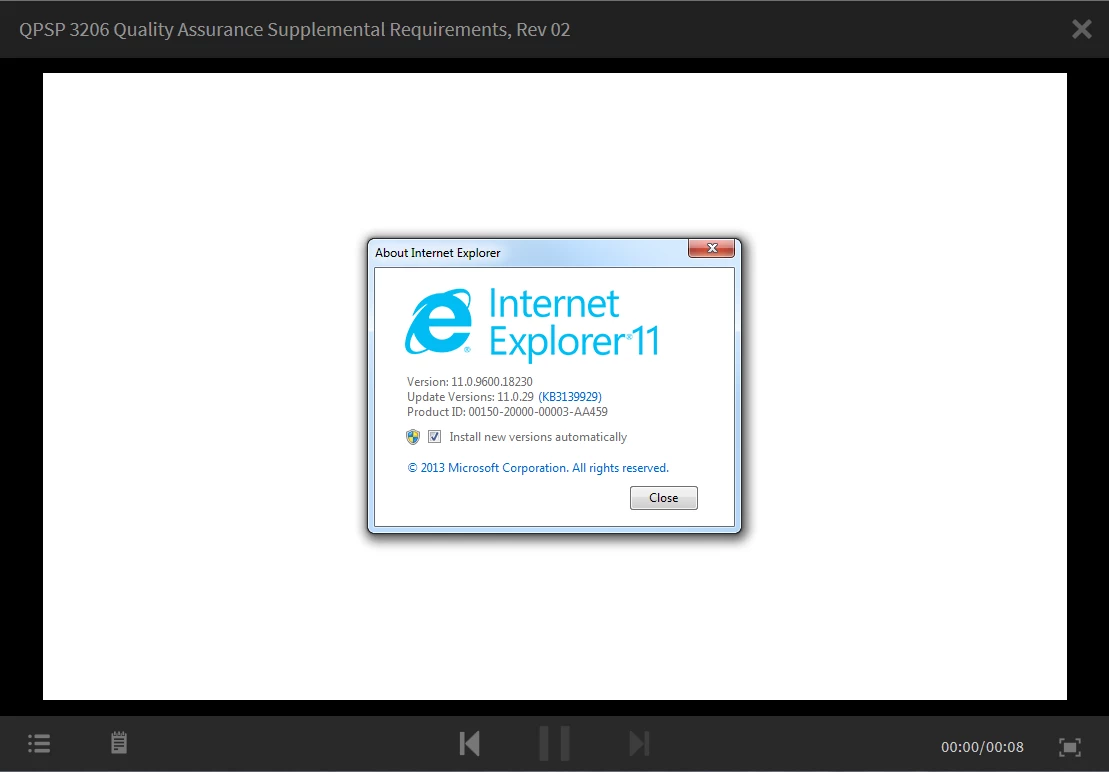

When I return to the course in Captivate Prime and attempt to run the second module (containing the Captivate 9 quiz) all I get is this:
I thought this might be a browser issue but as you can see, we are running IE11. Even if I have something amiss in the quiz settings I would think I'd at least see something other than a blank white image in the player...
Thoughts?
