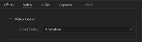

This page says that the Quicktime Animation codec is supported for export in AME.
https://helpx.adobe.com/media-encoder/using/file-formats-supported-export.html#video:~:text=HD-,QuickTime,Animation,-Apple%20ProRes%20422%20Proxy
I'm running AME 14.3.1 on Windows 10  and this codec doesn't seem to be listed anywhere.
Is this information up-to-date?

Set the Format to QuickTime and go down to the Video tab and change the Video Codec to Animation.

rocketmotion
Aug 2, 2020 3:57 PM UTC
Thanks, that's it! I knew I used to be able to see it somewhere in AME.

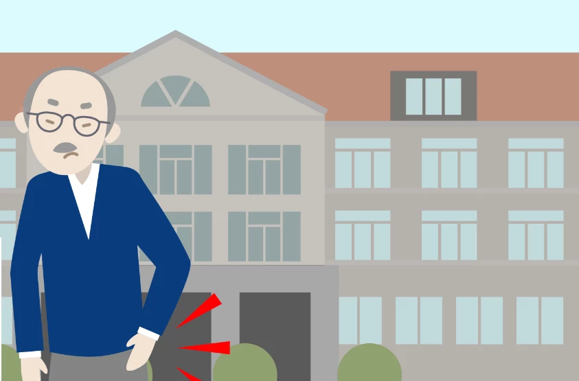

I do explainer videos and graphics that use solid colors, like this:
For these kinds of videos, the animation codec is the most efficient one.
Here's the same video rendered with the suggested alternative codecs:
The Animation codec has the smallest file size and identical quality. In some cases, the difference in file size is even more dramatic.
That is why I prefer the animation codec for graphics and Animation. I guess because that's what the codec was speciffically built for.
