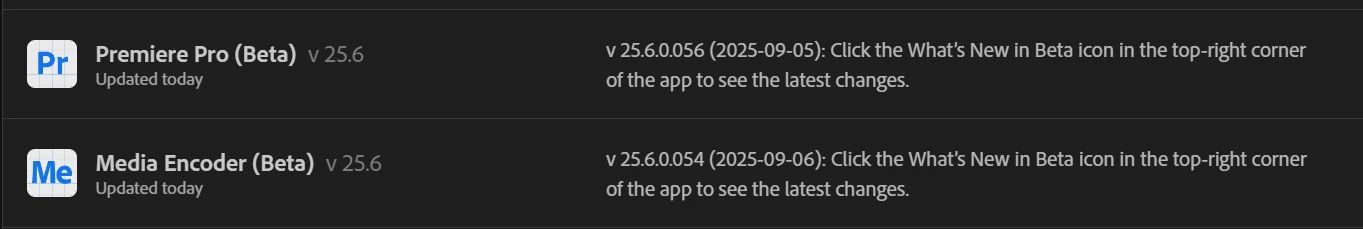

This appears to be fixed in version:

Sep 8, 2025 7:51 PM UTC
It's fixed. But it feels now that is rendering at a lower, MUCH lower speed than before. Videos in 4k that took me 30 minutes tops, to be rendered, now take up to 3 hours to finish.

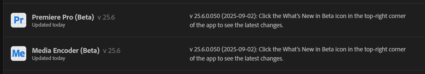

Sep 3, 2025 12:38 AM UTC
This is not fixed in Sept 2 builds either, still broken.  I have a feeling its broken when you enable the new premier project file for AI object masks - but I cant go back and test this now.....
Versions:
Media Encoder 25.6.050 Sept 2
Premier Pro 25.6.0.040 Sept 2
Versions are synced and error persists.

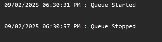

09/02/2025 06:30:57 PM : Encoding Failed
Could not read from the source. Please check if it has moved or been deleted.
LOG shows the following non helpfull information:

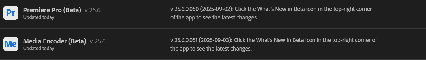

Sep 3, 2025 3:55 PM UTC
Still not fixed in todays build of Media encoder.....
